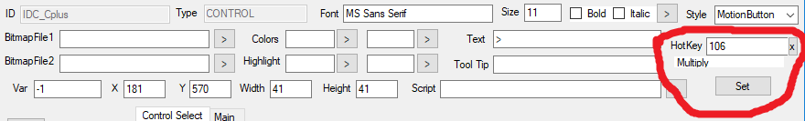

Thanks for the reply as you have said earlier I did edited KmotionCNCscreen editor to use DIVIDE KEY and MULTIPLICATION KEY to set keyboard jog for my c axis. I have set the key according to the sceenshot attached. But i am not able to run the C axis with above keyboard buttons.
Is there any other changes than screen editor Hot keys 111 and 106 respectively. I want to set those keys to jog my C axis similar to X,Y,Z,A. As in picture i already set it in screen editor but it is not working.
Please help me to add a jog button for C axis.

- Posts: 2942
Re: Shortcuts to Kmotion Axes Jog for B, C, U, V
Hi Amit,
It seems to work fine for me.
Did you set all 3 buttons to the same hotkey?
Did you push the "Set" button?
Is "Keyboard Jog" enabled?
Are there any duplicate Hot Keys defined"
Attached is a working example.
Thanks for your reply.
I have done that. and i have seen your post in that KmotionCNCdlg file there is an option to set axes from 4 to 6 then it will work.
And it is working fine to me.
