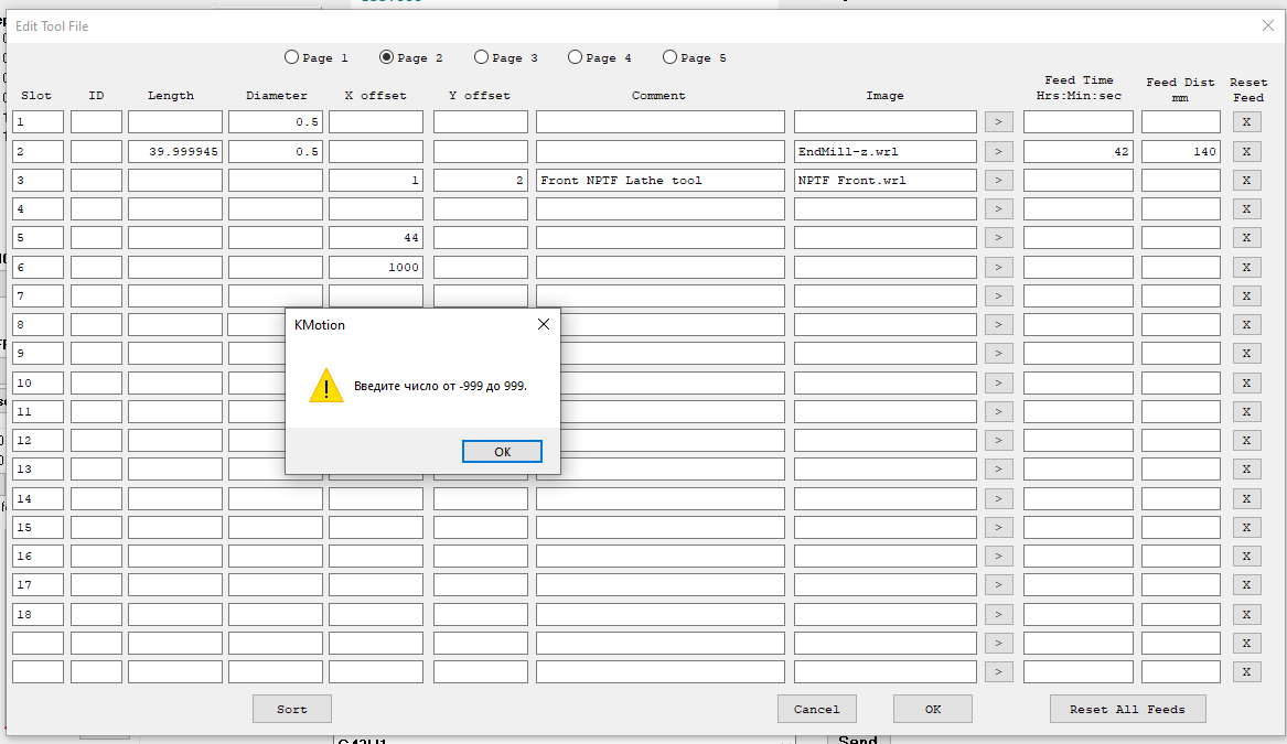

Re: On hower
Hi Tom.
Where can you increase the range of numbers entered into the table of instruments ?
It is currently limited to 999.
Taras.
Taras.
- Posts: 2868
Re: On hower
Hi Taras,
These lines and similar in EditToolFile.cpp
DDX_Text_Blank(pDX, IDC_Length0, m_Length0);
DDV_MinMaxDouble_Blank(pDX, m_Length0, -999,999);
