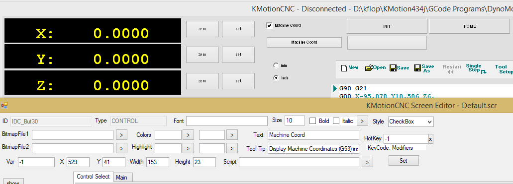

Using 4.34j with the 'scaling' screening editor.
I can't seem to get a Checkbox to display as a checkbox. Is there a sequence to do so? I even tried copying and pasting from the one existing checkbox control, didn't help. Here is a screen shot of the "default.scr" open with a label set to type checkbox, it's directly below the only 'standard' checkbox on the screen from which I copy and pasted. You can see it displays as a button.
Thanks!
Greg.

Hi Greg,
There aren't any additional checkbox controls other than the existing ones with their built in functionality.
You should be able to do something equivalent or similar with a Toggle Button. See:

Ah OK. When I made my custom screen a long time ago I did use a toggle button. I saw checkbox as an option in the latest and thought that be an option now.
