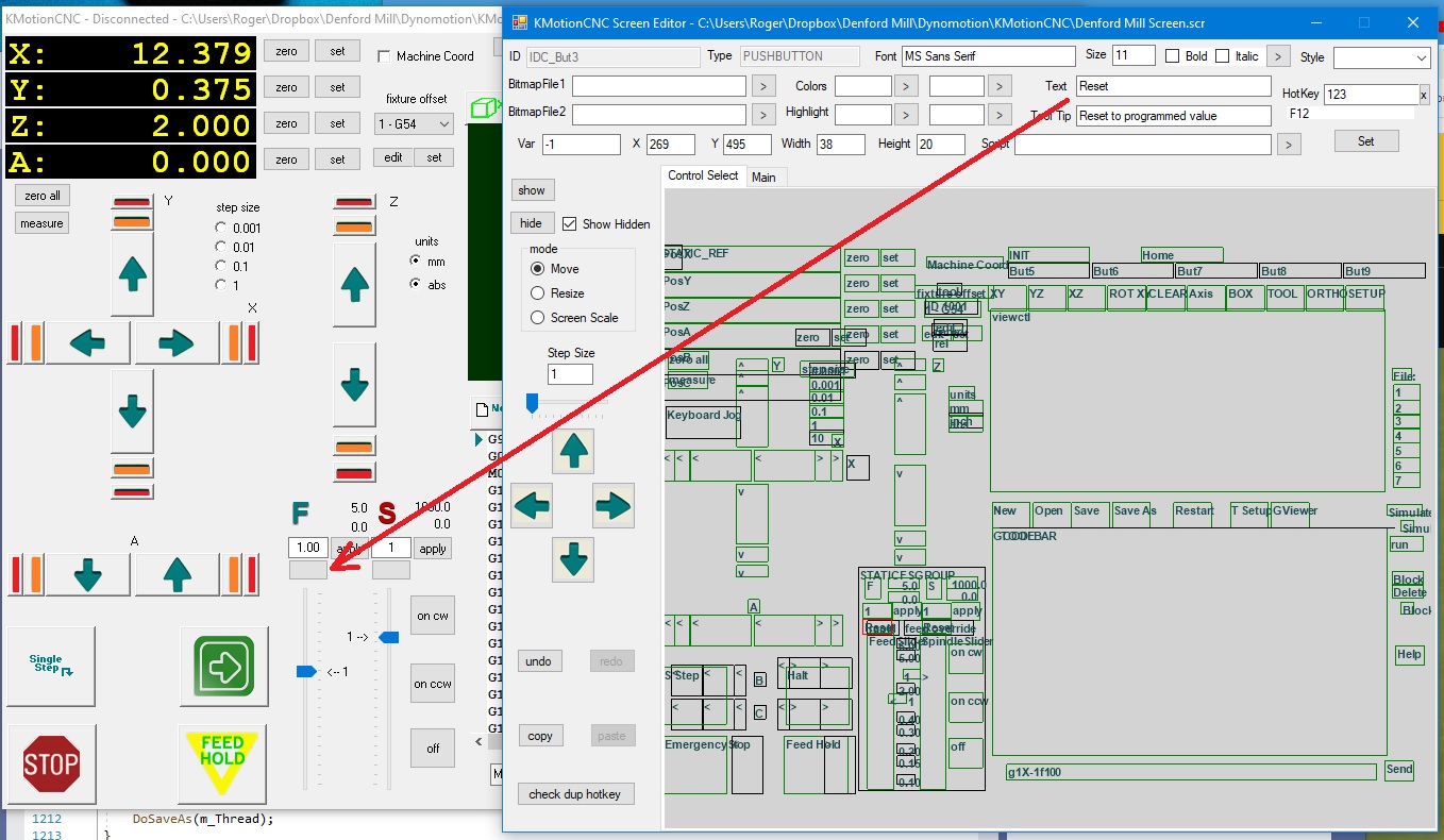

I've moved user button 3 to the position shown by the red arrow, and expected the 'Reset' text to appear in the box, but it remains blank. I've already done something similar when I added the Home button, and that works fine. I've looked as the two different buttons, and i can't see why it works on one and not the other.
Am I missing something, or is this a bug?
- Posts: 2868
Re: Setting button text
User Buttons 0-9 (IDC_But0 - IDC_But9) are the legacy (prior to Screen Editor) User Buttons that can be configured with text and shown/hidden from the Tool Setup | User Buttons Screen. Avoid using those in the Screen Editor or configure both to display in the same manner.

Is there a way to put text in them? If not, I'll just leave them as they are, I know what they do.
Wouldn't it be a good idea to implement them so they work like the others? If not, it would be less confusing to just delete them, and save questions like this that I have to post, and you have to answer.
