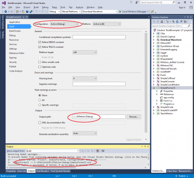

Yes, I had built the libraries for debug as stated here:
https://www.dynomotion.com/wiki/index.p ... plications
But still the error persisted occurring.
What truly solved was to add the directory <install dir>/KMotion/Release to the Path in the environment Windows variables.

That will work fine but you shouldn't need to do that. Did you check where your .exe was actually being placed? Sometimes when VS projects are upgraded for new Versions VS changes where the output is to be placed.

I was just trying to run the VCS code examples in debug. I am not sure about which .exe you are talking to.
I opened it in Visual Studio Community 2015.
Sincerely,
Guilherme
Re: Unable to load KMotion_dotNet Libraries error
Posted: Fri Jul 07, 2023 5:26 pm
by TomKerekes
Hi Guilherme,
The .exe of the example you are trying to run. For the example SimpleFormsCS it would be SimpleFormsCS.exe
