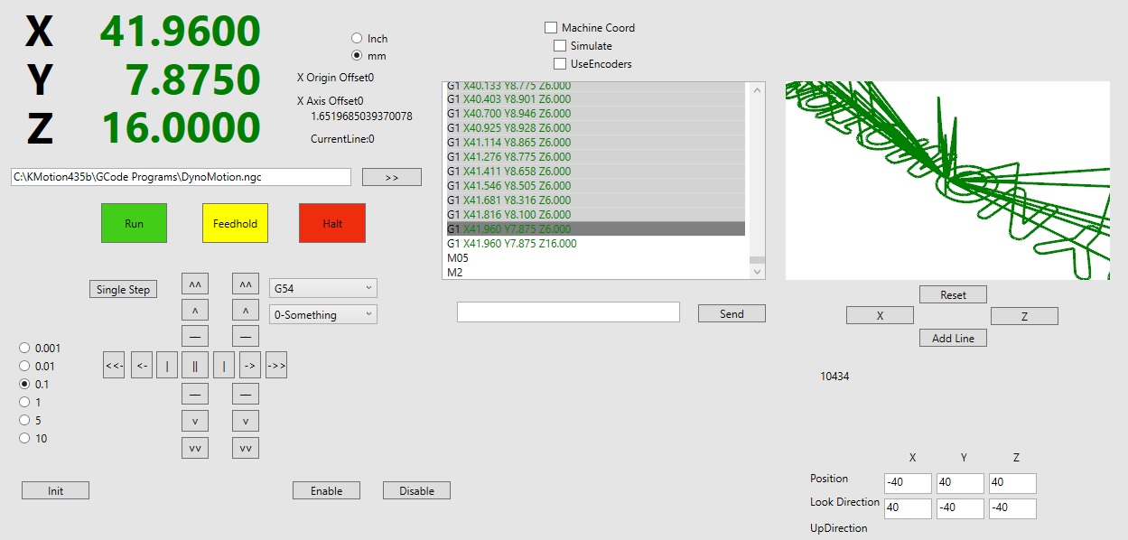

I've hit an issue with the graphics :-/
If I single step through the code (I'm using Dynomotion.ngc), everything works as I expect. I step 20 times, the handler triggers 238 times, and if I step as far as the first 'o', it's been triggered over 10'000times.
However, if I try running the code (either in simulation, or with a machine running) the handler only gets triggered 982 times.
I thought it was something to do with how I was generating the graphics, but even stripping the code back to just a simple integer counter/label that increments each time the handler gets called, the issue remains.
I'm adding the handler in LaunchExecution-
Then the handler is simply-
With the handlerTest displayed on a label every timer tick.
The only difference I can see between single stepping and run, is the handler gets added every time single step is triggered, but from my understanding, that's how KMotionCNC does it as well...
Any ideas?
KM.CoordMotion.CoordMotionStraightFeed += new KMotion_dotNet.KM_CoordMotionStraightFeedHandler(StraightFeedHandler);
private void StraightFeedHandler(double DesiredFeedRate_in_per_sec, double x, double y, double z, int sequence_number, int ID)
handlerTest++;
//Viewer_AddLine(new Point3D(x, y, z));
Any ideas?

I've just realised what the problem is.
The handler use inches, but I've had a bug in my single step code, where the first line gets skipped, so the G21 was ignored, I've not realised, and I've not been zoomed in close enough to see anything other than a green blob in my viewer.
Plus I seem to have an issue where in simulation, the DROs get converted twice from inch to mm (i.e. 1inch = 645.16mm)
I knew it would be something stupid.
I now need to work out how I'm going to handle arcs, and fix the bug where traverse lines are always starting from the origin.
