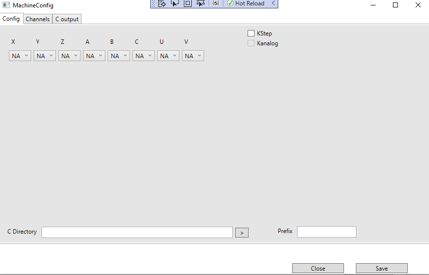

That's the directory I have set in that .xml file I attached, but it can be set via the C Directory on the Config page -
It is however currently using a bit of bodge in order to select the directory.
The WPF OpenFileDialog doesn't directly support selecting a folder, so I either need to resort to the Windows Form FolderBrowserDialog, use a third party implementation, or roll my own.
However, I've not decided on the final layout/functionality, so I'll live with the bodge for now.
