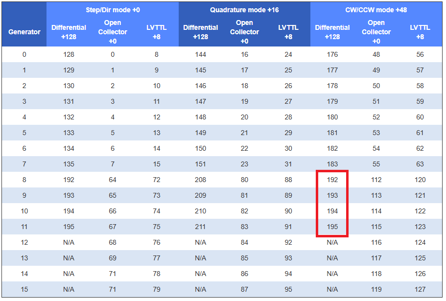

Not really a bug, but I figured this is the best place for it.
The Step/Dir generator value table values (on https://dynomotion.com/Help/StepAndDire ... rKogna.htm ) are wrong for channels 8-11 for CW/CCW and Differential mode. You have them the same as Step/Dir mode (192-195), whereas I make them to be 240-243

Hi Moray,
Thank you for reporting this issue - it has been fixed now.
