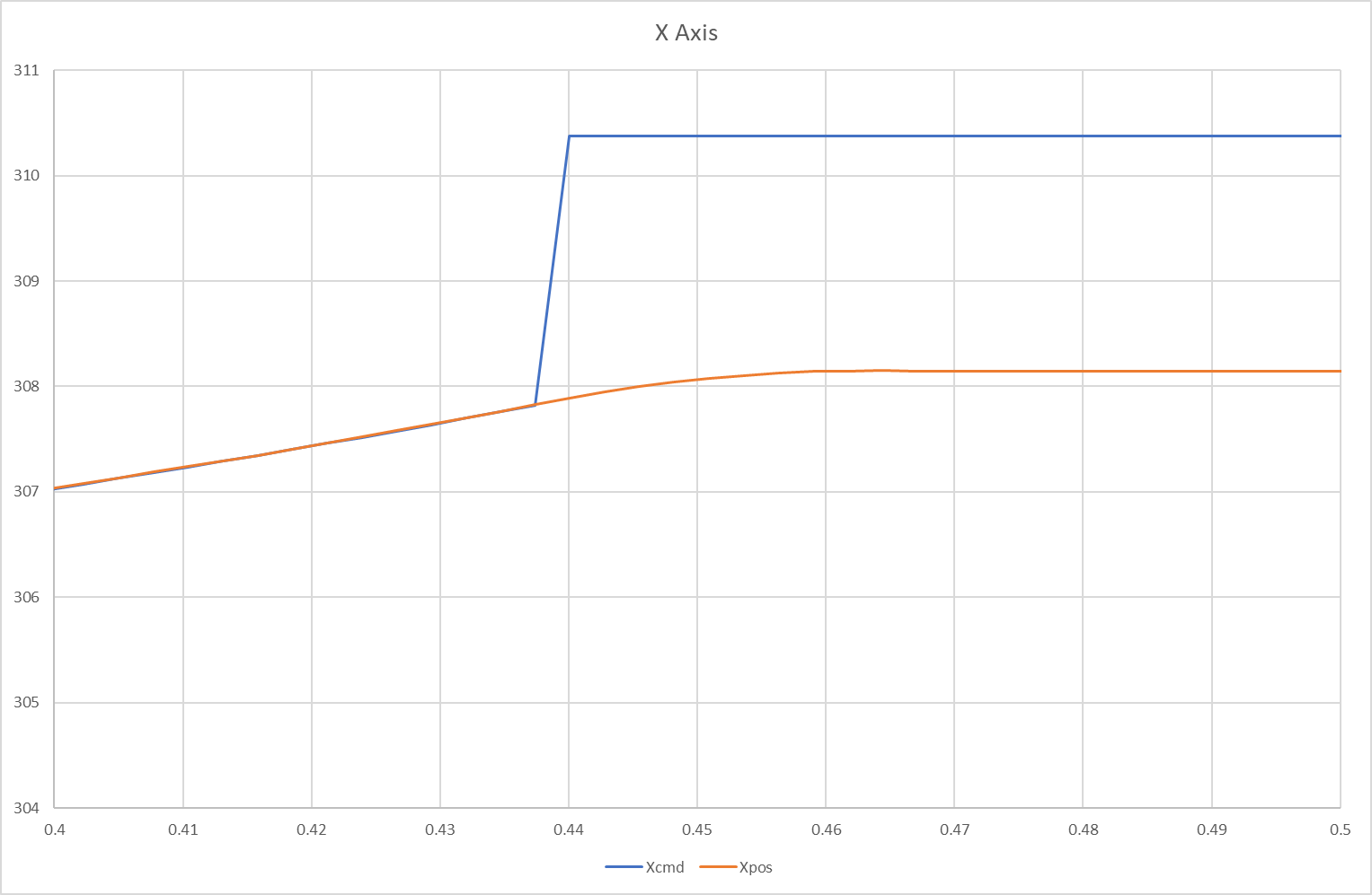

4 - I captured motion during event; X commanded position suddenly goes away from the planned path (as well as Y). This could be the result of skipping the G0 Line but still changing the destination. Please see attached pic.
I also begin to suspect something corrupting on my side. Can it happen for some faulty access to a pointer in C code (I mean accessing to wrong address)? I will try to reduce all the C code to its minimum (I don't know if I can stop it at all because of watchdog) and the repeat the tests.

Since it is repeatable it should be straightforward to track down. Since it shows in the commanded trajectory it shouldn't be dependent on any hardware. So you should be able to disconnect all hardware, set following errors to infinity, no watchdog, etc and still observe the problem.
If you do this I should be able to reproduce and help find the problem.
