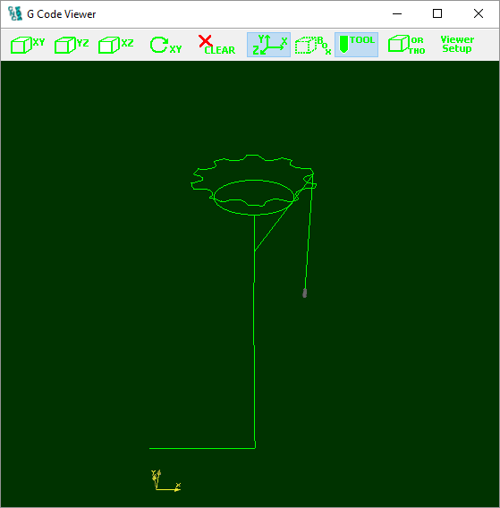

I plotted your GCode:
How much Coordinated Motion Buffer that is used will depend on the Trajectory Planner Smoothing and corner rounding. I ran the code with these typical settings:
The GCode took 42 seconds to execute and generated 4068 Coordinated Motion Segments and used 878KBytes of memory. Just under the 1MByte of Flash space available.
Attached is a MonitorParametricIndex.c program that will display on the Console how much Coordinated Motion Data has been downloaded as the GCode is running. When the GCode finishes it showed:
ParametricIndex=4068 (878688 bytes) 83.80 % TimeDownloaded=42.441sec
