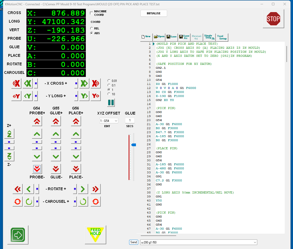

I forgot to add the screenshot of the red feed rate slider which moves up and down when the Probe , U axis is moved either using manual jog or CNC.
No other axis has this strange behaviour.
I am only using the blue pointer to set the glue time.
Any ideas why ?

Red Spindle Feedrate Slider
- Posts: 2951
Re: Red Spindle Feedrate Slider
Hi Tim,
The Red bar is normally used to show that actual measured spindle speed. It reads the Axis configured for the Spindle. Set the Threading Sensor Type to 0 (none) to disable this.
Normally to do Probing an axis is commanded to do an independent Jog and then a C Program loops watching the Probe input. When detected stops by commanding a Jog Speed of 0. See the ProbeDirection.c example
