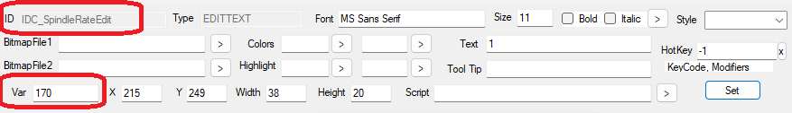

We don't currently have a command to read the SSO value only set it. But you can read the contents of the SSO Edit Control.
To do so set the Var of the Edit Control to a unique persist Variable such as 170 like this.
Then you can read it from KFLOP like this:
int main()
	char s[80];
	double SSO;
	// Read String from a KMotionCNC Edit Control
	// Persist Var identifies the Control and contents specifies
	// where the string data should be placed in the
	// Gather Buffer as an offset in words
	if (GetEditControl(s, 170, 1000))
		printf("Error Reading Edit Control Var=170\n");
		printf("String=%s\n",s);
		sscanf(s,"%lf",&SSO);
		printf("Value=%f\n",SSO);
