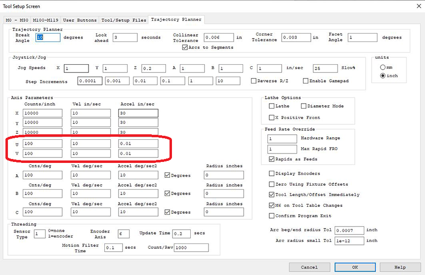

After more thinking and experimentation I think the standard 6 axis screen will work with the 6 linear axis and a C program called by an M code will move the 2 rotary axis.
I assume KMCNC will not command a G code U or V axis move as there is no where to axis scaling, velocities and accelerations ?

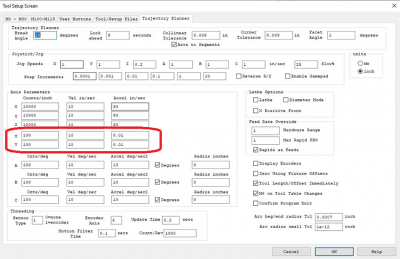

The GCode Interpreter supports the U and V axes for a total of 8 axes. The scaling and such are set on the Tool Setup | Trajectory Planner Screen |Axis Motion Parameters.I assume KMCNC will not command a G code U or V axis move as there is no where to axis scaling, velocities and accelerations ?
