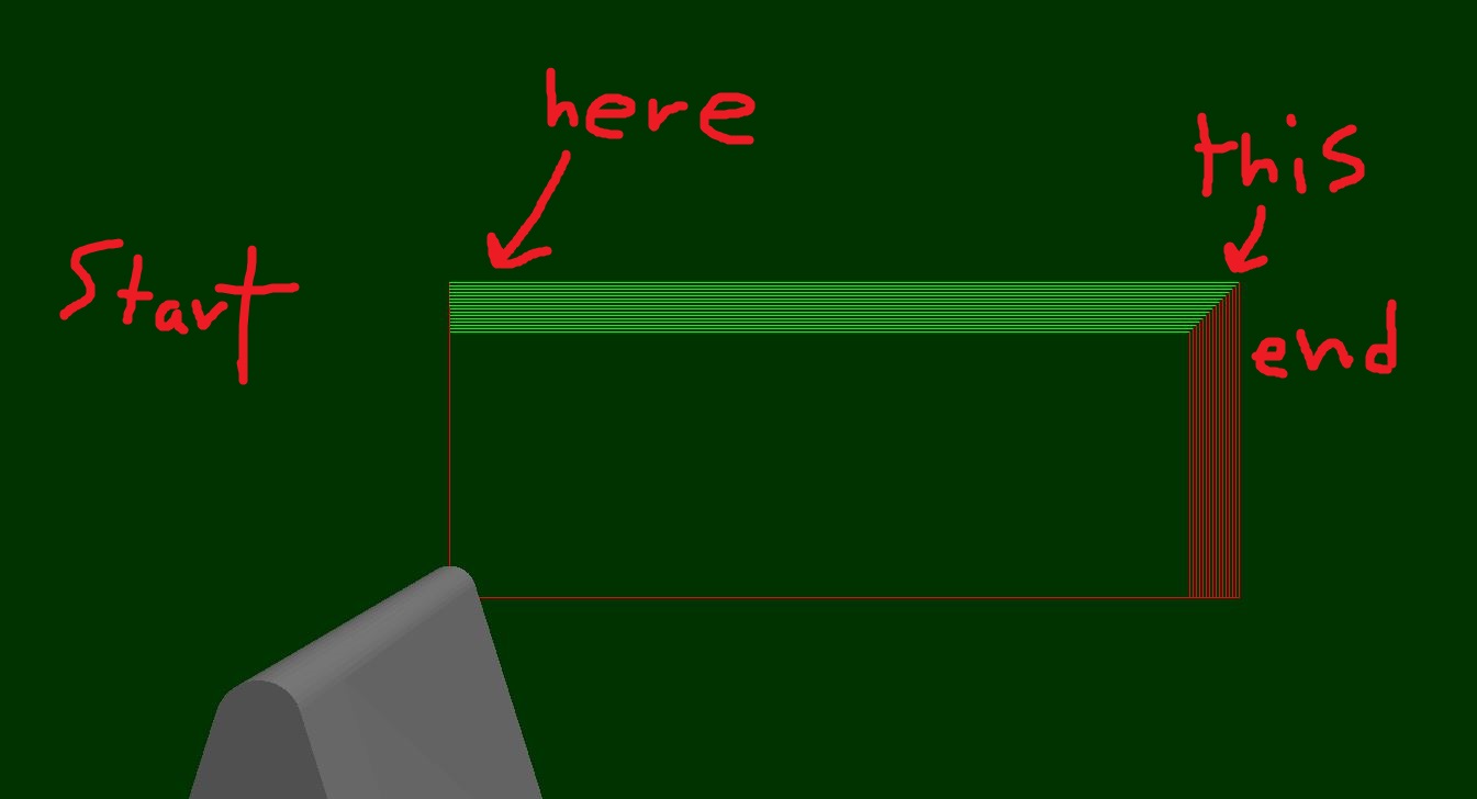

chatbots got me mostly there but i cant get the Z increment on the start side of the cut
( threading starts at Z zero )

Posts: 2901
Re: threading macro help
Post by TomKerekes » Mon Jan 22, 2024 6:17 pm
I think at the end instead of always moving Z back to 0 move to #10

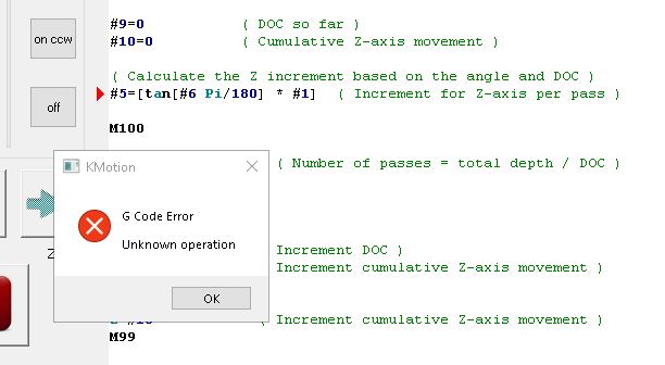

i had chatbot modify it further to make it more user friendly in that an angle can be directly input and the macro would do the math but i think it is too much as it does not work

Posts: 2901
Post by TomKerekes » Mon Jan 22, 2024 9:21 pm
GCode trigonometric function parameters are in degrees not radians.
turbothis
Posts: 331
Location: southern oregon
Post by turbothis » Mon Jan 22, 2024 9:36 pm
i figured there would be something like this way over my head!
Posts: 2901
Post by TomKerekes » Mon Jan 22, 2024 9:59 pm
Just remove the * 0.0174533 (PI/180) which is converting from degrees to radians
turbothis
Posts: 331
Post by turbothis » Mon Jan 22, 2024 11:46 pm
ok
what is the (PI/180) ?
Moray
Posts: 307
Post by Moray » Tue Jan 23, 2024 12:04 am
ok
Pi/180 = 0.0174533
It's how you convert between Degrees and Radians.
turbothis
Posts: 331
Post by turbothis » Tue Jan 23, 2024 1:09 am
oh boy i made it angry again
