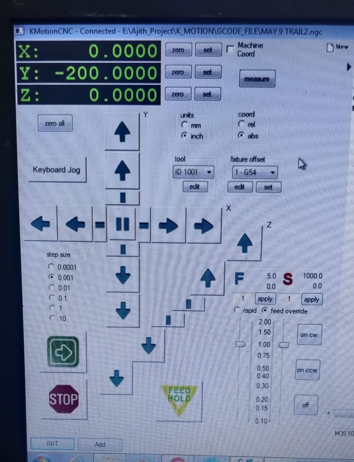

is there a way to move the kmotion cnc jog value directly moved a permanent variable by configuring a button in the screen.
I don't understand the question. What is a cnc jog value?
As you know, the above screen is the kmotion cnc screen and there is an option to jog the corresponding axis where ever i want. my question is that whether i can read or store the value displayed in the screen whenever i jog our axis, by pressing a customized button and use that value directly in my gcode variable. That is whenever i press that customized button my coordination value used in the gcode need to be replaced with that jog value.
Posts: 2891
Re: saving the kmotion cnc jogged value to a permanent common variables
Post by TomKerekes » Thu Jun 02, 2022 4:49 pm
after creating a geo file and how can i use the value in the geofile.
Did you read the link?
See the SetFixtureZ.c example which reads the KMotionCNC DROs and uses it to adjust the GCode Fixture Offset by changing a GCode Variable.
I had gone through the program but i have tested the program in kmotion but i dont know where the value is saved. i had noidea how to use that program in my application. whether i need to assign the program in user button in toolsetup screen in kmotion cnc
Posts: 2891
Post by TomKerekes » Fri Jun 03, 2022 4:35 pm
I had gone through the program but i have tested the program in kmotion but i don't know where the value is saved.
When the SetFixtureZ.c program executes you should see the KMotionCNC Z DRO change to zero. You can see that a Fixture Offset changed by using the fixture offset edit screen. Fixture offsets for all the axes and all the fixtures are stored in GCode Parameter Variables starting at #5201. The Variable for G54 Z is #5223
If you want the program to run when a User Button is pushed then yes.
Are you saying that if i jogged my motor to a certain position using the kmotion cnc screen and then execute SetFixtureZ.c program.the value in the dro will changed to 0 and the fixture offset value will be changed to the jog value. but when i execute SetFixtureZ.c program in kmotion ,i think there is a 'get' command used in the program to get value from the user but the program didnt wait to get value from the user.
yes i want and is it possible to assign that c program to a button. and how can i do it.
Posts: 2891
Post by TomKerekes » Wed Jun 08, 2022 3:48 pm
Correct
No it doesn't ask anything of the Operator.
See here.
