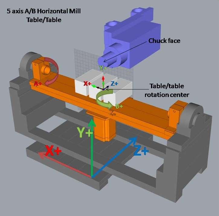

Hi there,
I have setup my Kflop card for my 5axis A/B table/table horizontal mill, without RTCP at the moment, using KmotionCNC.
My goal is to implement RTCP feature using KmotionCNC, I have read many times the wiki and the forum but I do not understand which are the steps to do this.
I have the 4.35b sw version and attached you can find the orthogonal kinematic of my mill, which is a standard table/table 5 axis but with the horizontal mill so it's an A/B configuration (obviously if I home the A axis rotated by +90° the kinematic is A/C but I need to keep the homing like the attached picture).
In particular to do this, can I utilise the "Alex's system with a Table A axis and Gimbal B axis (Kinematics5AxisTableAGimbalB.cpp)" with the pivotchucklenght set to 0?
or I have to modify the "5AxisTableAC" kinematic?
after this doubt, which is the procedure step by step to do this, in order to use RTCP?
please help me
thanks

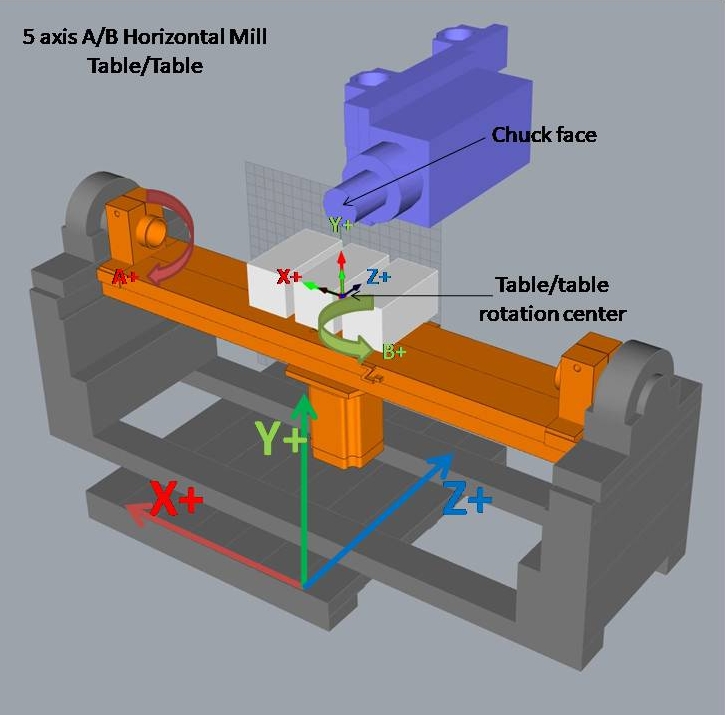

please help me
thanks

I think a TableAB Kinematics will need to be created for that.
Its not clear whether the marked directions are for moving the table or the tool.
What steps in the wiki don't you understand? Have you been able to re-build the libraries with Visual Studio 2015?

Hy Tom,
thanks for the quick reply,
the marked direction are from the tool point of view, in specific the table moves in X and Z (in opposite direction vs the marked direction, i.e. when it moves X+ the table goes in X- direction, the same for Z moves), while the horizontal mill moves in Y as the marked direction (Up is Y+).
I have installed VS2019 community edition with C++ and MFC, but I do not know anything about it.
Could you please help me in order to create the generic TableAB Kinematics? obviously I will insert the offset values from home vs the table rotation point in mm or inches.
Is there a step by step guide/link to re-build the libraries?
I need to do this before or after having the new TableAB Kinematics?
thanks for your help, I am sorry but I have never used an IDE before,
all my best
all my best

I think either could work. I'd suggest having the home routine set the machine coordinates not to zero at the home position, but to whatever values such that 0, 0, 0 will be at the centers of rotations. That way if something changes the home routine can be adjusted and keep the machine coordinates the same.If my mill homing is at the max values for XYZ axis (than set home position to 0 machine), should I insert the negative machine distances of the above variables (rotation center/Z C face) from the mill machine home coord.(0,0,0)?
