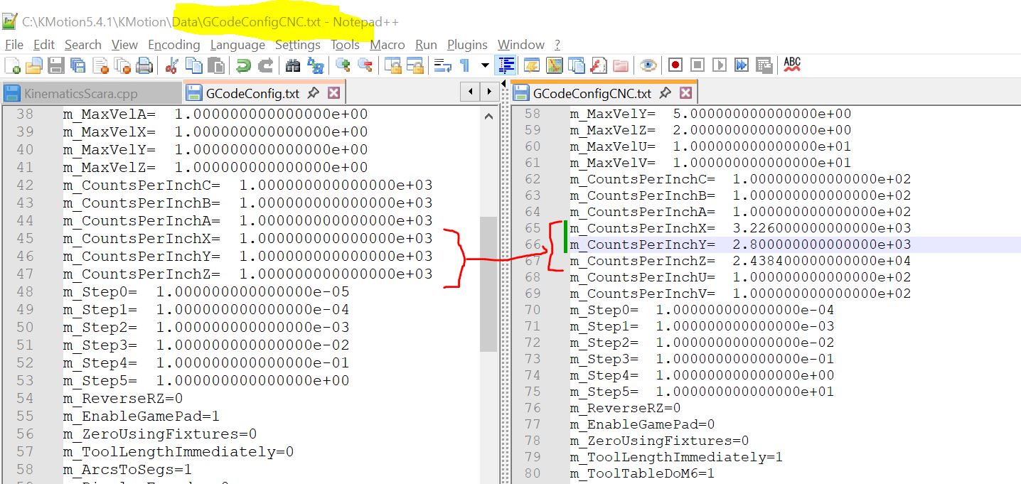

I did try setting the count/deg in the trajectory planner to negative but I don't think that was right. And, oddly, now that I changed x and y ( I mistakenly changed y) I can't seem to set them back? I tried removing the minus, but they seem to persist after choosing "OK" and also after a restart.
That's a silly bug we've been struggling to get rid of. Once the values are set negative they can't be changed from the GUI. If you exit KMotionCNC and manually edit the file \KMotion\Data\GCodeConfigCNC.txt CountsPerInch parameters to a positive number then the GUI should allow you to change them.
Should I also change the value counts per values in the similar file GCodeConfig.txt?

Its not necessary. That file is used by the GCode Screen in KMotion.exe which is obsolete and replaced by the KMotionCNC Program.

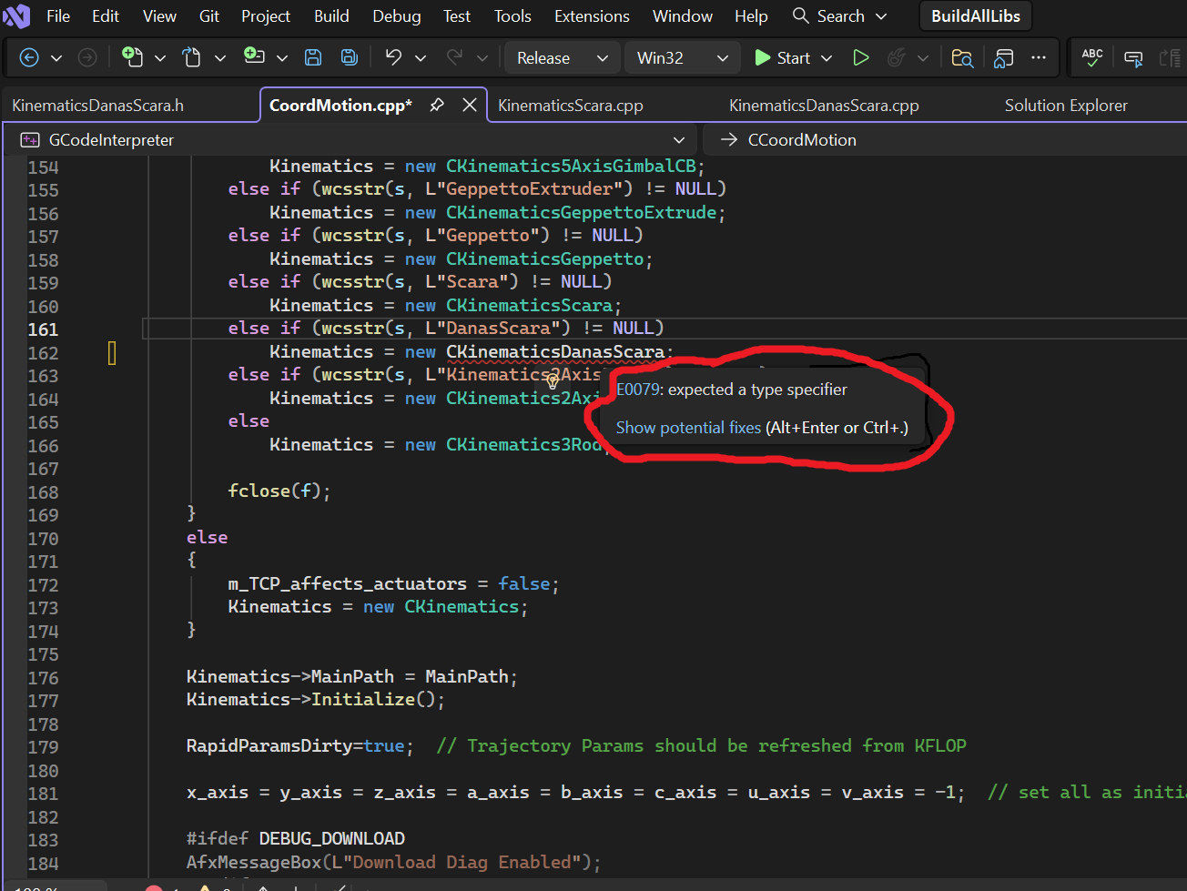

I Went back through how I set my kinematics file and found I had a bug/typo in theCoordMotion.cpp file
else if (wcsstr(s, L"Geppetto") != NULL)
Kinematics = new CKinematicsGeppetto;
else if (wcsstr(s, L"Scara") != NULL)
Kinematics = new CKinematicsScara;
else if (wcsstr(s, L"DanasScara") != NULL)
Kinematics = new CKinematicsScara; // This should have been CKinematicsDanasScara
else if (wcsstr(s, L"Kinematics2AxisRobot") != NULL)
Kinematics = new CKinematics2AxisRobot;
Kinematics = new CKinematics3Rod;
Problem is when I I update the file I'm getting a type error. I'm clearly missing something from when copied and refactored the CKinematicsScara files, but I'm missing what?
Any quick solution?

I added my header as in include in CoorMotion.cpp to resolve the error. I think this is probably not the right way? But I was clean able to clean and build all libs.

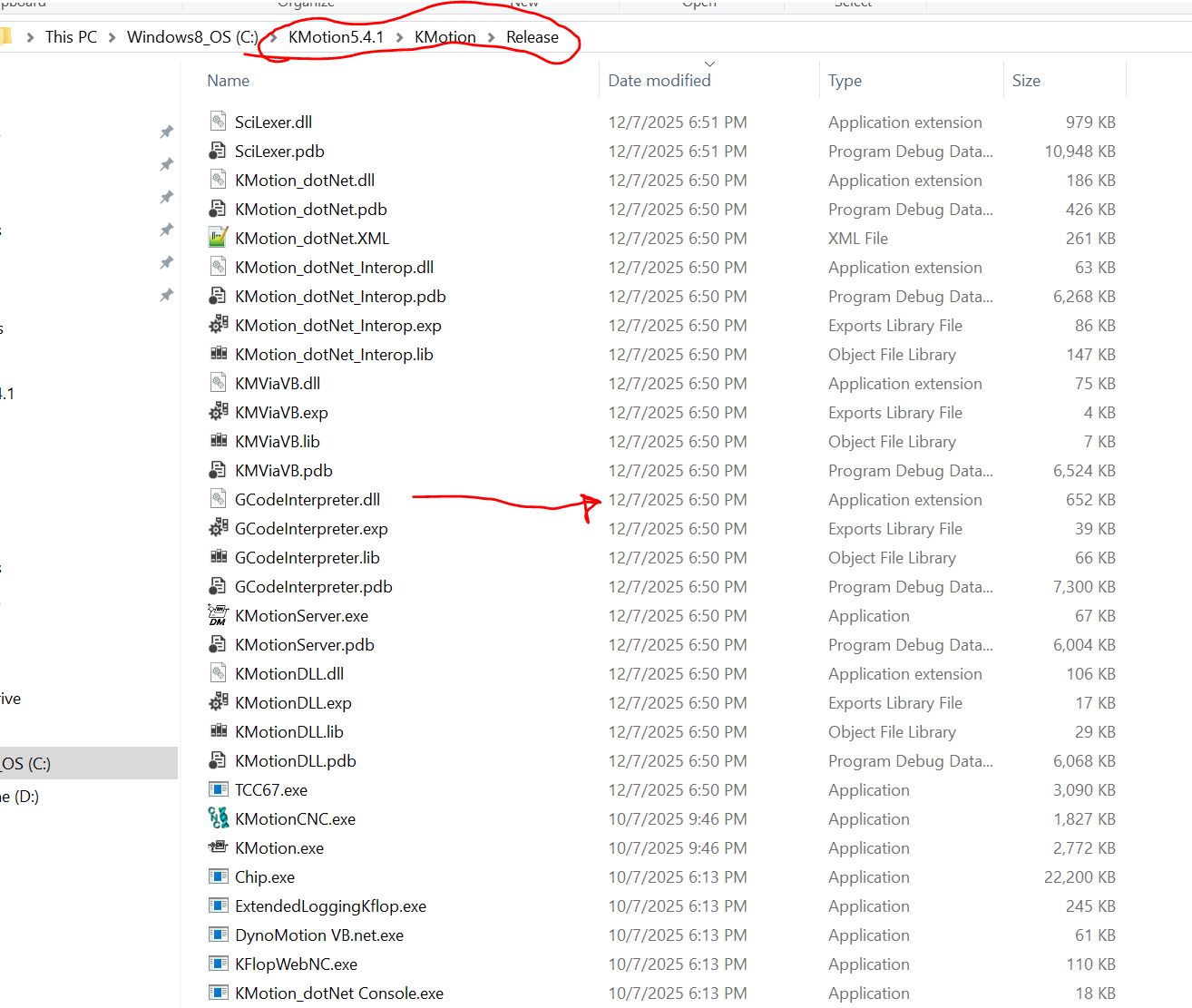

Problem now is KmotionCNC is still seeing the old file. So I guess one problem, I probably not building correctly? I did clean and build and think it built for release for win32.
I will go back through the docs on building.

// CoordMotion.cpp: implementation of the CCoordMotion class.
#include "stdafx.h"
#include "CoordMotion.h"
#include "HiResTimer.h"
#include "KinematicsDanasScara.h" // <-- add this include

Including your .h file is the correct way to define the class.
The problem is that DanasScara contains the term Scara and it checks for Scara first and finds it. Reverse the order of the checks to check for the more specific case DanasScara first and it should select yours. We should probably do an exact match check instead of any match.
