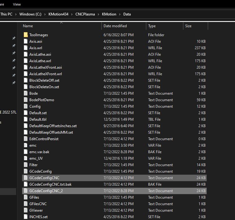

Tom maybe I was confused when I copy/pasted on what you were looking for...
Anyway yes the two config files are in that correct folder C:\KMotion434\CNCPlasma\KMotion\Data...
Posts: 2906
Re: Multiple KMotionCNC Machine Configurations
Post by TomKerekes » Wed Jul 13, 2022 11:57 pm
I think you are hiding file extensions of known file types. So the filename is actually:
GCodeConfigCNC_2.txt
not
GCodeConfigCNC_2
a_j_p3
Posts: 16
Joined: Sun Aug 26, 2018 10:15 pm
Post by a_j_p3 » Thu Jul 14, 2022 12:02 am
that worked!
Thank you! I personally would never have figured that out.
