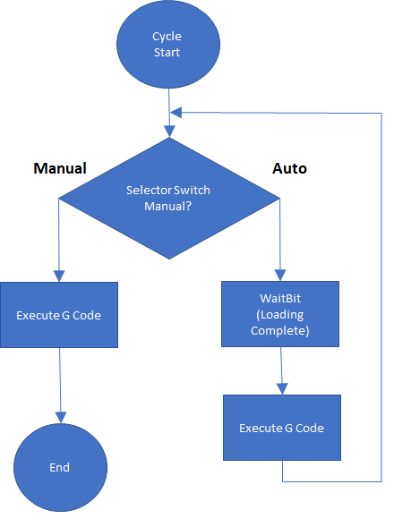

This flowchart explains what I am attempting to do. I have the waitbit down, and your loop explains the logic. I am just missing how to change the variable in the G code based off of the switch.
Scott
Scott

Thanks for the flow chart. But a few things still aren't exactly clear. When would the operator change the mode switch?
Do you realize with your proposed method if the system is in auto mode, running GCode, and the Operator switches to manual, then the GCode will finish, then run the Manual GCode, then stop. Would that make sense?
Is the Manual GCode and the Auto GCode the same?
I also see other issues:
#1 If running in Auto mode and waiting, switching to manual might then wait forever?
#2 Interpreting GCode has look ahead. The Interpreter executes, works ahead, and buffers the motion in KFLOP. The benefit of this is that the motion can be performed with zero (less than 90us) PC/Windows/USB delays. The WaitBit doesn't actually make the Interpreter wait. Instead it inserts a command in the motion sequence to wait at that point in the motion, then proceeds. So for example say that KMotionCNC is set to do 10 seconds of buffering and the GCode sequence involves 2 seconds of motion. In this case the Interpreter will loop 5 times putting 5 sets of motion and waits into the queue. The effect of this will be that switching from Auto to Manual mode will result in 5 more Auto cycles and then one manual cycle before finishing. Probably not what you want?
To avoid the look ahead issue you can place an MCode Execute Action in the loop. When encountering the MCode the Interpreter will wait until all previous buffered motion completes before executing the MCode. The disadvantage would be that the MCode itself and then re-filling the motion buffer to resume motion may then take some time and introduce a delay (probably a few milliseconds on average, on occasion longer depending on Windows).
If I understood your requirements better we could probably find a proper solution with zero delay at least most of the time.
If any delay was overlapped with the Loading operation then that would be fully optimal also. What triggers the Loading?

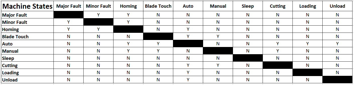

I appreciate the detailed reply. To help you understand, we have 30+ small CNC machines being run by KFlops on our factory floor with a desire to build more. The main issue is the actual cycle time for the machines is quite small (4-10 seconds), and the way I have them programmed causes long delays. Sometimes the machine will stall during each cycle for 10 seconds or more. Other times it is as little as 0.5 seconds. The wide swing makes things problematic.
The machine is actually much more complicated then the flow chart suggests. I am attaching a truth table that indicates all of the machine states. The Kflop is controlling an auto loader, KMotionCNC, and and unloading chute. The idea is to have a factory worker be able to turn the switch to "Manual" sit in front of the machine and load parts all day, pressing "Cycle Start" each time. They could turn the swith to "Auto" and it self loads, Cuts, and unloads. This is all currently working, just with delays.

Thanks for more info. I don't understand the state table matrix - other than I can understand what the states are.
You still didn't indicate whether the manual and auto GCode are exactly the same. The reason I ask is that I'm thinking to get the absolute best performance it might be best to basically keep the GCode in a forever loop with a single WaitBit in all cases. Then use a C Program that performs real-time logic based on Manual/Auto, Interlocks, Load/unload state etc. So then in Manual Mode when the Operator pushes a "Go" button the C Program could immediately Clear/Set the WaitBit and motion would begin instantly.
If this "Go" button was an external button hard wired to KFLOP the response would be 100% guaranteed instantaneous. If the "Go" button were a User Button on the Screen to just set a KFLOP IO Bit, the delay should be very minimal. Although nothing in Windows will never have significant delays on occasion.
Of course in Auto mode state changes of the Loader/Unloader could be detected and trigger the motions to start instantaneously as well.
Does this approach sound reasonable?
As a side note. I'm surprised you see delays of over 10 seconds. I would expect delays of ~0.5 sec 99% of the time because of several 0.1 sec status update times in KMotionCNC. Then maybe delays of 1 second (an additional 0.5 sec) ~1% of the time. Then several seconds like 0.00001% of the time. Something odd must be going on like a flood of requests to KMotionCNC or something.
