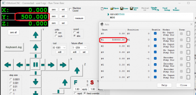

But even so the 503/500 scaling would initially be the same. Your file seems to work for me. Below you can see the GCode commands 500mm and the actual axis position is 503mm (I set 1000 counts/mm resolution)
