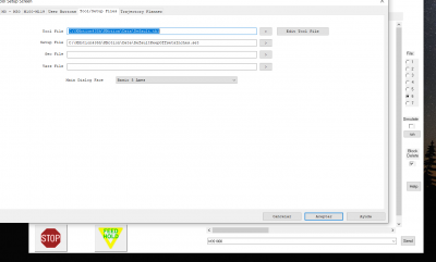

I have copied the provided scara kinematics file and made one change to the arm lengths. But I am missing where I set values for pulses per degree?
Maybe these come from setting up KmotionCNC? I think I could set the values directly in my kinematics file, but I think I'm missing something as the example file reads them in?
Posts: 2868
Re: Softlimits and scara kinematics
Post by TomKerekes » Sun Nov 30, 2025 10:16 pm
Hi Dana,
Yes if you’re using KMotionCNC those can be set in the Tool Setup | Trajectory Planner Screen. Note even though the variable is called CountsPerInch it is actually counts per degree for an angular axis.
