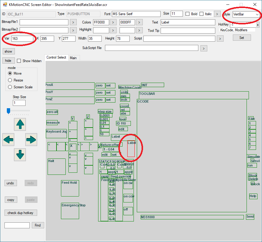

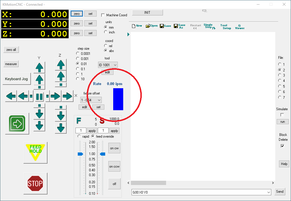

Hi Thomas,
Yes. You might see the Screen example ShowInstantFeedRate3AxisBar.scr that shows the feed rate as a value and as a Bar Graphic.
The C Program example ShowInstantVelocityDROBar.c updates the Value and the Bar Graphic periodically.
You can read the current value of a Kanalog ADC with ADC(n).
You can use KOGNA_CONVERT_ADC_TO_VOLTS(v) to convert the ADV counts to Volts if needed.
