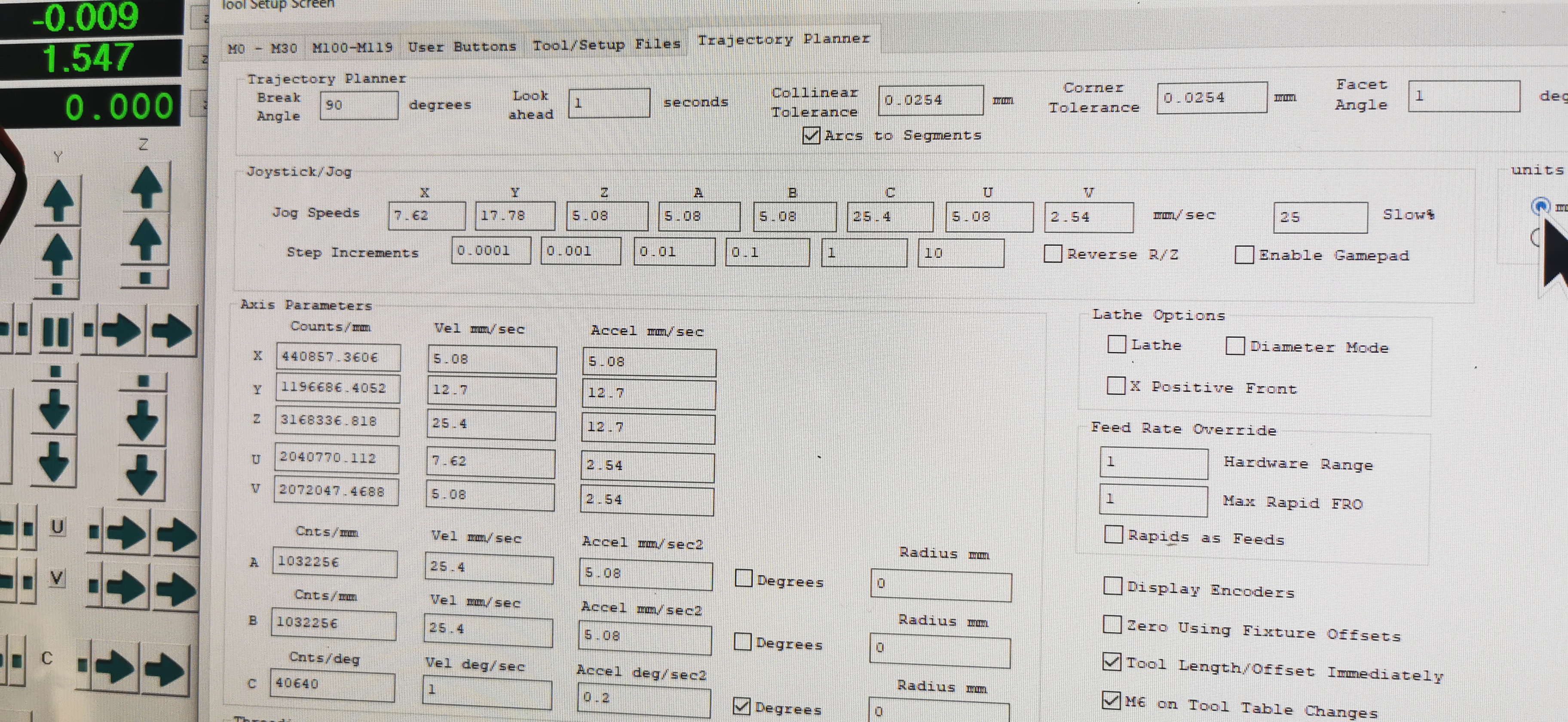

Hi Tom , the axis is working now , I have some problems that I'm trying to fix myself, however I have discovered what appears to be a bug in the 5.3.5 version , trayectory planner
If you set up for inches , and then press the units radio button in the trayectory planner to mm it will multiply the number of steps (counts ) per mm in the axis ..should it be dividing the counts?

- Posts: 2928
Re: DRO Not Zero After Homing
Hi Mariano,
Yes you are correct. This should be fixed in 5.3.6.
