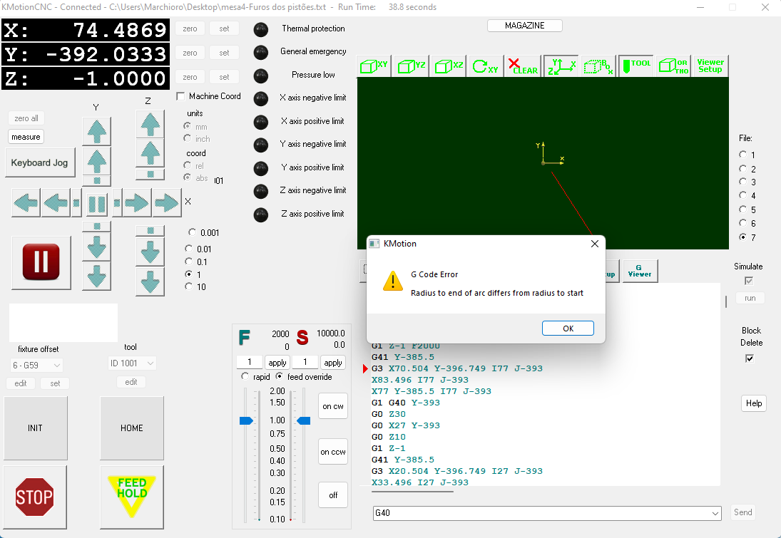

I am getting some warnings when trying to run G code generated by AlphaCam.
One of them is that when G2 or G3 command uses I and J parameters, KMotionCNC shows the following warning. The same does not occurs if instead of I, and J, the parameter R is used.
