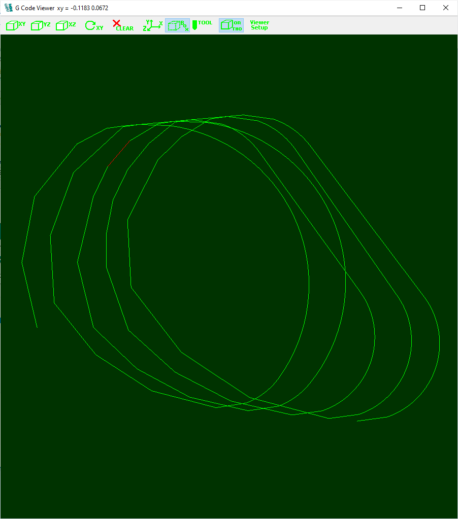

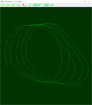

The GCode is a bit segmented in that area but that shouldn't cause an error.
Here the "error" segment shown in red:

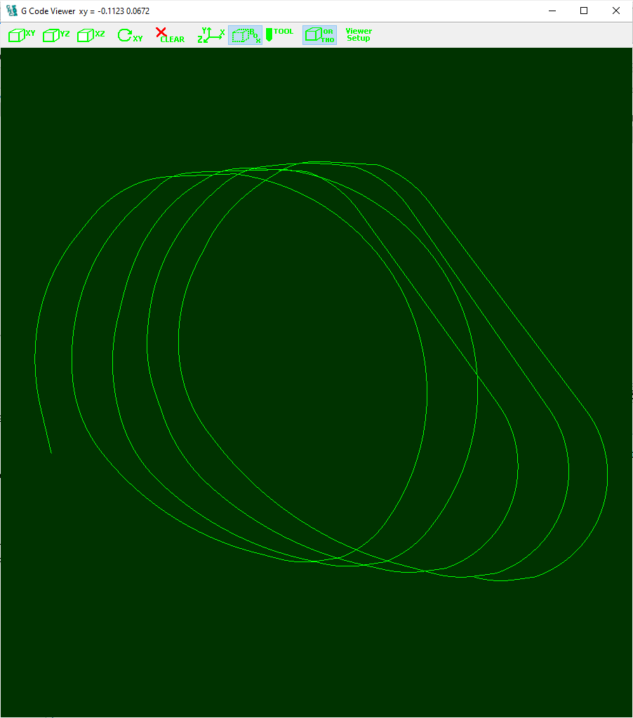

Corner Rounding smooths it:
