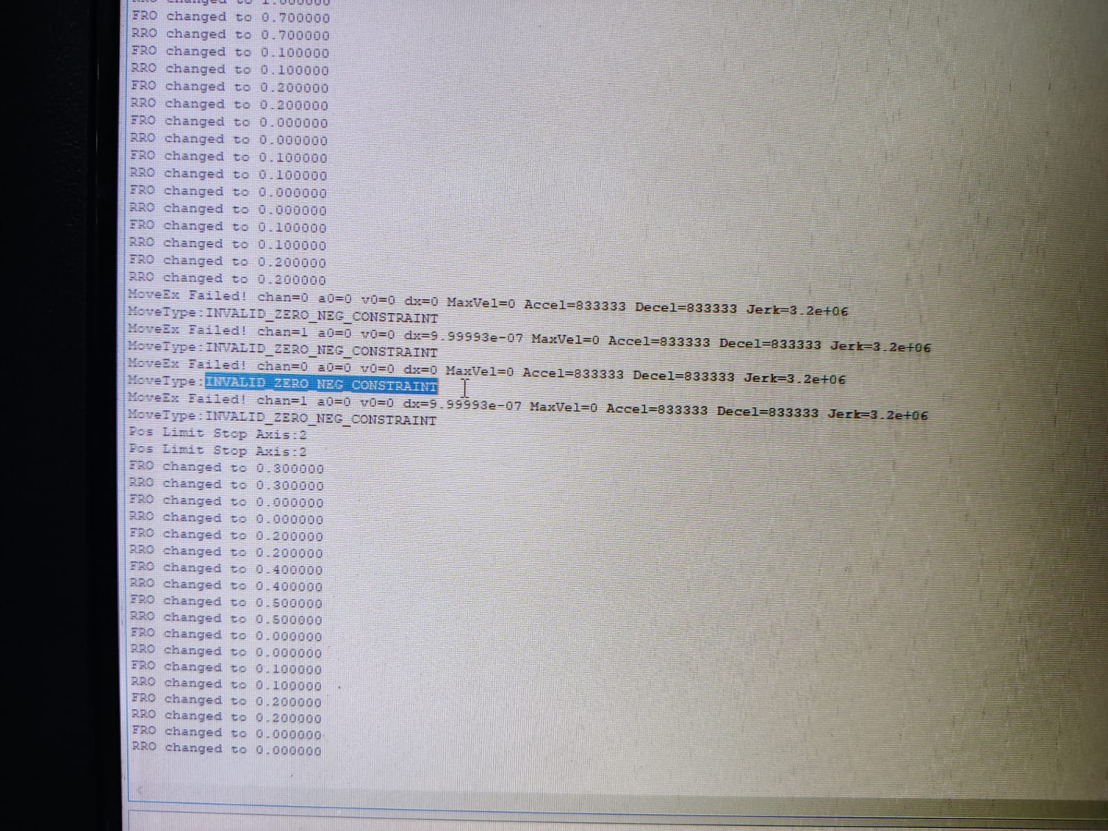

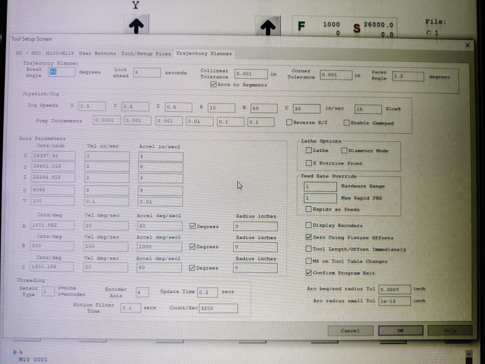

I am using Kflop+Konnect for my 5 Axis cnc machine.
I am facing strange problem (INVALID_ZERO_NEG_CONSTRAINT) while running attached g code.
I have attached the trajectory planner settings and G code in which i am facing the error. Even i tried increasing decimal in g code as well but still facing same error.
Please help me in finding the error and how to fix the same.
Waiting for kind reply.

Re: INVALID_ZERO_NEG_CONSTRAINT error while running 5 axis G code
Hi Amit,
That error shouldn’t come from GCode. It indicates a Move command from a C Program with a Max Velocity of 0. The C Program causing error might be invoked by an MCode within the GCode.
What line of GCode causes the error?
What C Programs are being invoked?
Can i post it instead of topicstarter?
KFLOP with just my breakout board start to behave strange after some time of work. At first it works fine, but then it don't want to react properly on step commands. I mean theese buttons
Console is filled with this:
MoveType:INVALID_ZERO_NEG_CONSTRAINT
MoveEx Failed! chan=0 a0=0 v0=1e-06 dx=2.03727e-09 MaxVel=0 Accel=6e+06 Decel=6e+06 Jerk=4e+07
MoveEx Failed! chan=2 a0=0 v0=4e-05 dx=3.08279e-06 MaxVel=0 Accel=2e+06 Decel=2e+06 Jerk=1e+07
MoveEx Failed! chan=2 a0=0 v0=0 dx=-1e-05 MaxVel=0 Accel=2e+06 Decel=2e+06 Jerk=1e+07
Looks like axis refuse to move with negative velocity.
Also what is biggest trouble, it can't properly execute G0 commands. Axis start movement to destination, but before reaching it goes back a bit and floats few seconds around that wrong position. Machine reacts to step commands similarly. It ends up with axis disable due to max following error. I tried to lower speeds and acceleration, that didn't help at all.
Init file attached.
Init file attached.

- Posts: 2917
What Version of KMotion are you running?
Somehow a microscopic move of Axis 0 is being commanded with a maximum allowed velocity of zero. When those errors are displayed enter 'Vel0' in the console screen to see if the velocity is really 0.
Regarding CSS: Please post your MySpindleDefs.h and CSSJog.c files.
Also post your \KMotion\Data\GCodeConfigCNC.txt so we know your entire configuration.
KMotion5.4.1
On older versions behaviour was the same, but i am not 100% sure.
Responce to Vel0
Same for period when console spam those messages, and when axis is standing still and console is calm.
About CSS files i didn't change CSSJog.c, just MySpindleDefs.
And a small update: previously stated step 3 is not needed. To activate SCC minimum steps are:
1. Init
2. At least once M3 G97 (G97 default mode, no need to write it)
3. Init again
Only after this, spindle will rotate in CSS mode.
Responce to Vel0
