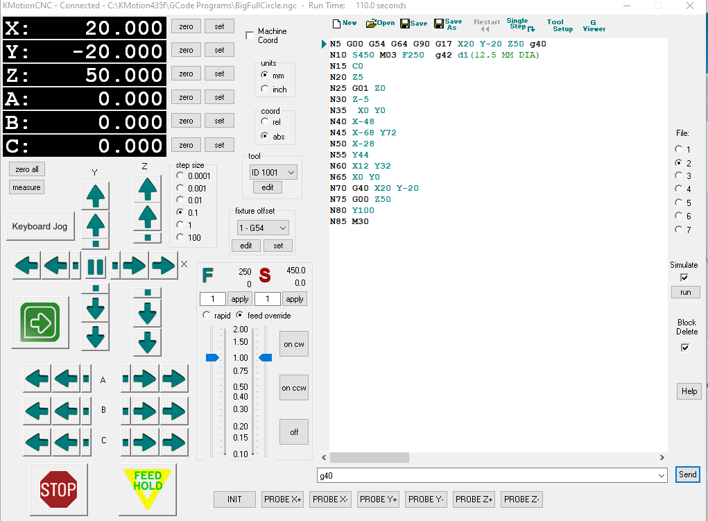

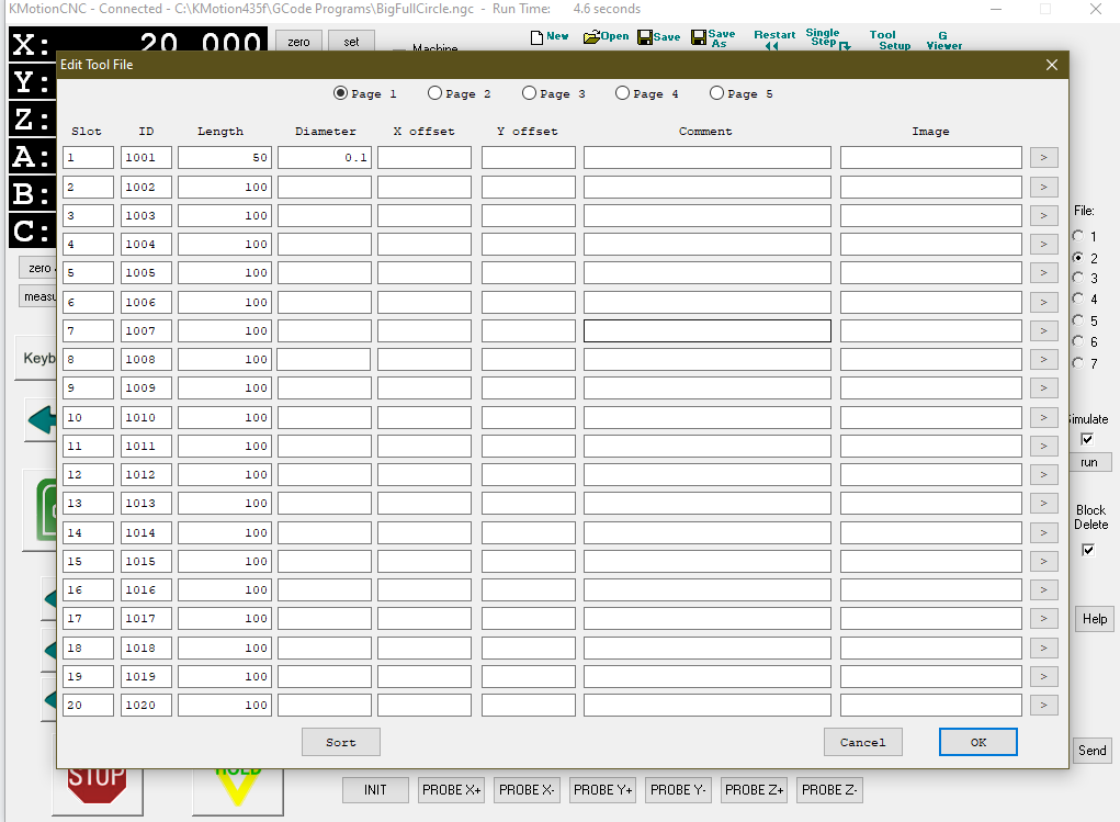

I am using Kflop+konnect for my cnc machine. I am facing one problem in G40, G41, G42 (Tool diameter compensation).

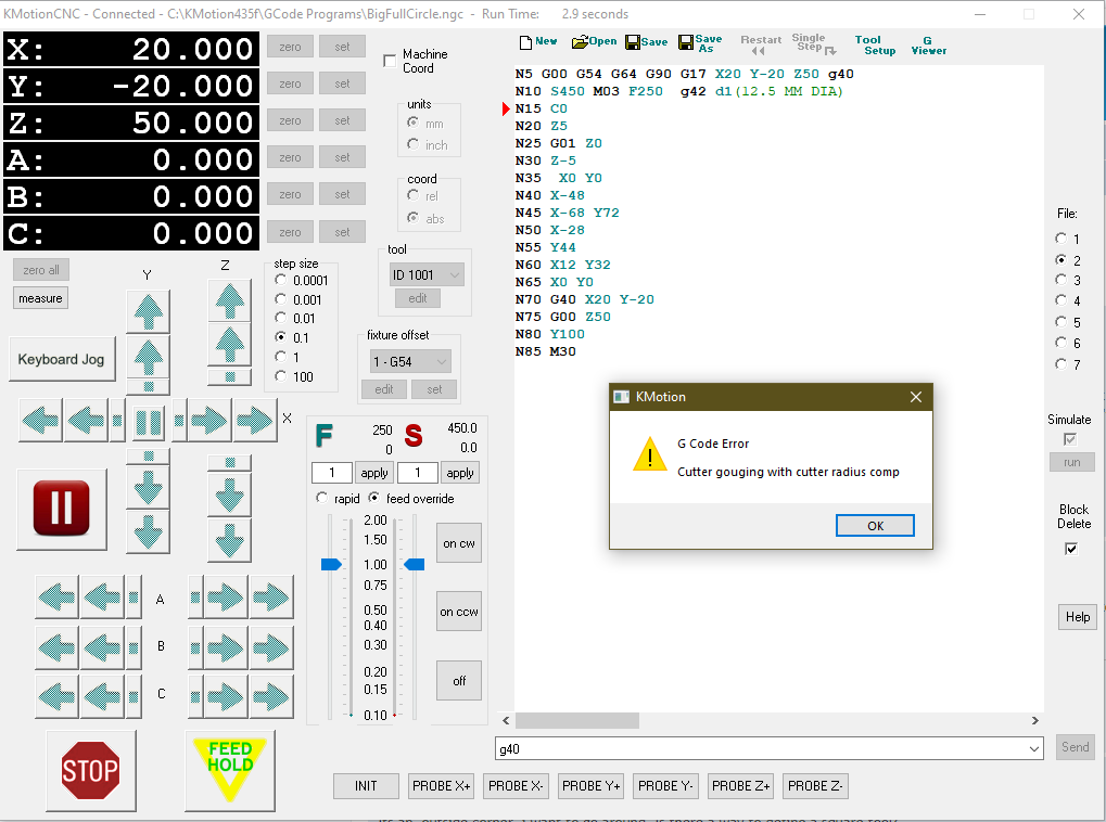

It is giving error of tool gauge while simulation as well as actual run of g code on machine.
I am attaching G code and screenshot of error i am facing.
Please suggest any probable solution of below problem. If I am doing something wrong ?

Hi Amit,
G42 moves the tool on the right side of the specified path. It is not possible to go through inside concave corners without gouging. What are you trying to do? Here is a plot of your GCode:
There must also be an Entry Move to apply radius compensation immediately after turning it on. See also.
