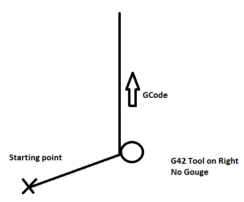

Posts: 2927
Re: Plasma cutter tool offset
Post by TomKerekes » Wed Mar 31, 2021 11:07 pm
I think it depends on where the tool is when you start the Job. You don't have a controlled entry move into radius compensation.
The GCode turns on radius compensation and moves to a starting point of X=672 Y=7 and moves upward.
If the tool begins on the Left of that point it is ok:
If on the Right there is a gouge
