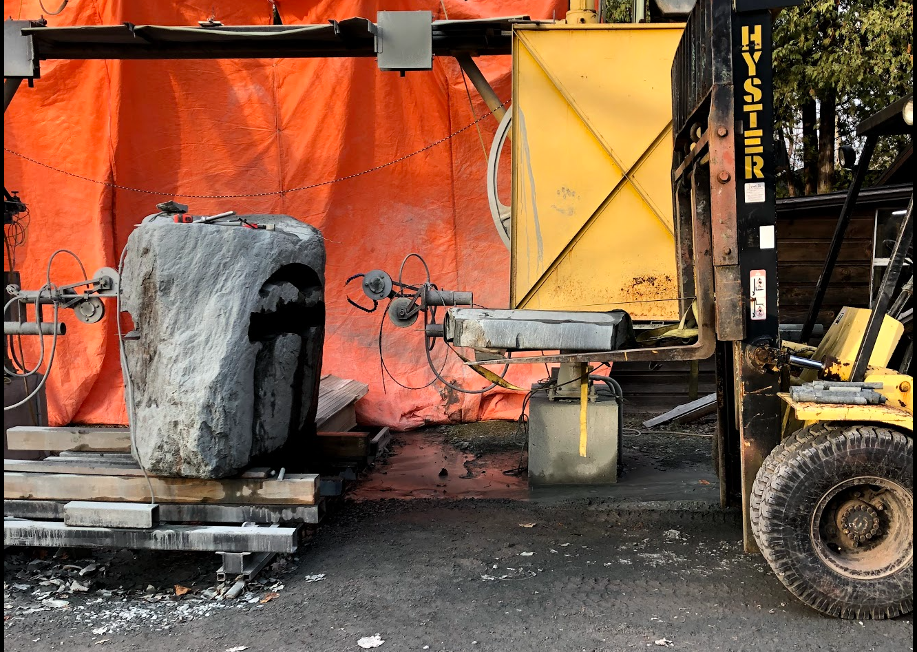

Yes that's what I have my custom MCode do (if I remember correctly). After each cut it pauses so I can remove the wire, then I press a button to continue execution to the next contour. In this case while KMotionCNC is waiting for me to press the continue (physical) button, I pressed the pause button. Then used the step buttons to move the X axis over so I could get the forklift in to remove the waste. Then I step back to where it stopped. Then press the start button. I do get a warning window pop up that the machine needs to move to last known location (which it is at), I leave the options in that dialog set and continue. Seems to work fine.

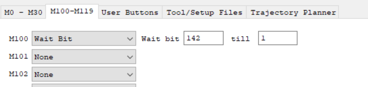

Sorry I was going on memory. I double checked and this is how I have my custom M code configured:
I wanted a physical button to press because I'm physically within the working envelope of the machine while paused. Right now the spindle is manually turned on/off but at some point I'd like to have that handled within KmotionCNC too. This is what I have the Sheetcam post do:
Right now the M5 M3 don't actually do anything with the spindle. I manually turn it off/on. When the end of the 'inner' contour is reached the M5 M100 is executed and the GCode processing halts waiting for me to press the physical button. This is when I turn off the spindle, then remove the wire so the machine can move to the next 'inner' contour. Once the wire is removed I press the button, the machine moves to the next start point, where I feed the wire through a hole. Then turn on the spindle, press the button and it starts cutting. Hope that is clear. It's at the stop point where I remove the wire that I pressed the pause button within KmotionCNC, and used the step button to move the x axis to allow removal of the waste.
