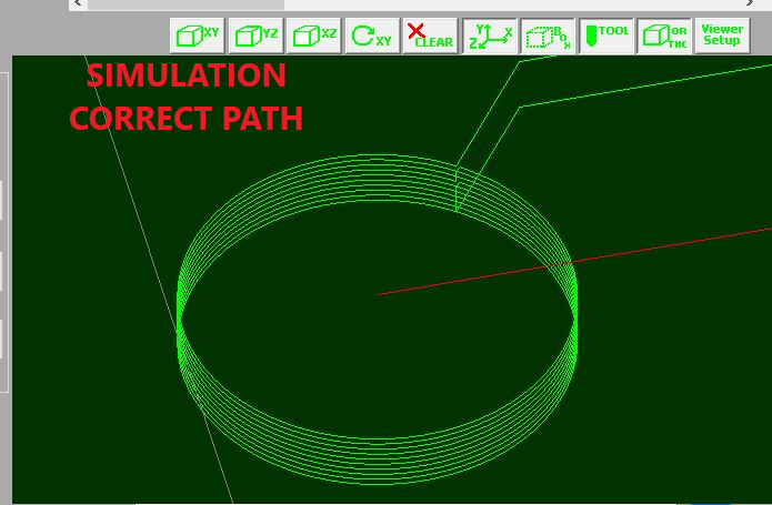

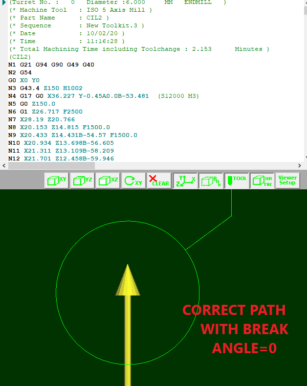

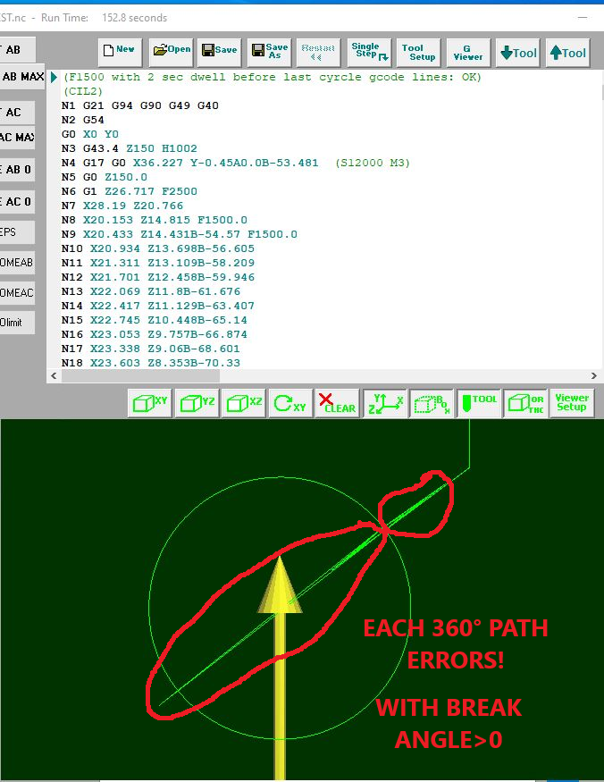

You are right, I had to disable the Break Angle because it produces dangerous gcode modifications during the mill operation, please find below the example of this (simple lateral cylinder mill in RTCP mode):

The Break Angle issue should be fixed. I normally set Break Angle to 179 degrees so everything is rounded where possible.

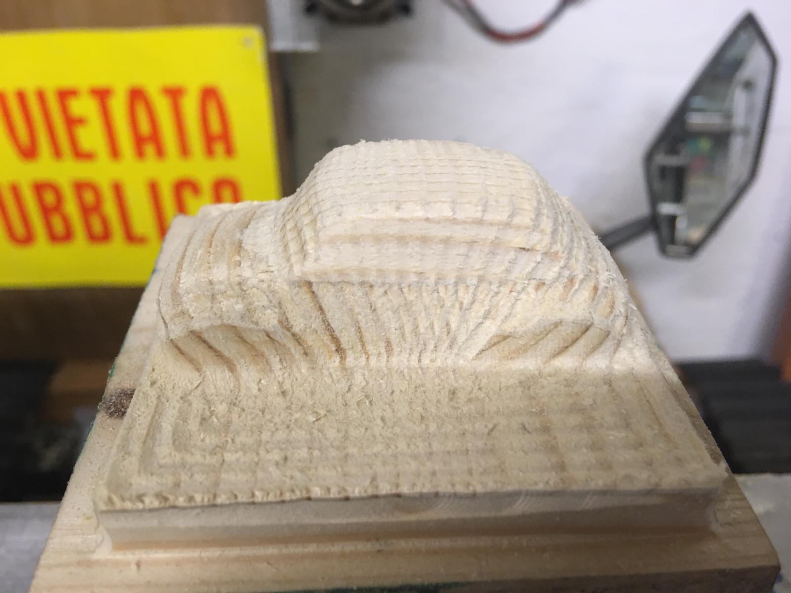

Running the GCode with the Kinematics is fairly smooth. But there are still some slowdowns in the corners but not for seconds like before where feed rate were comletely wrong. This is because of some quirks in the GCode. Here is a zoom in. Notice the zig-zags

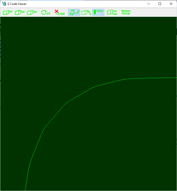

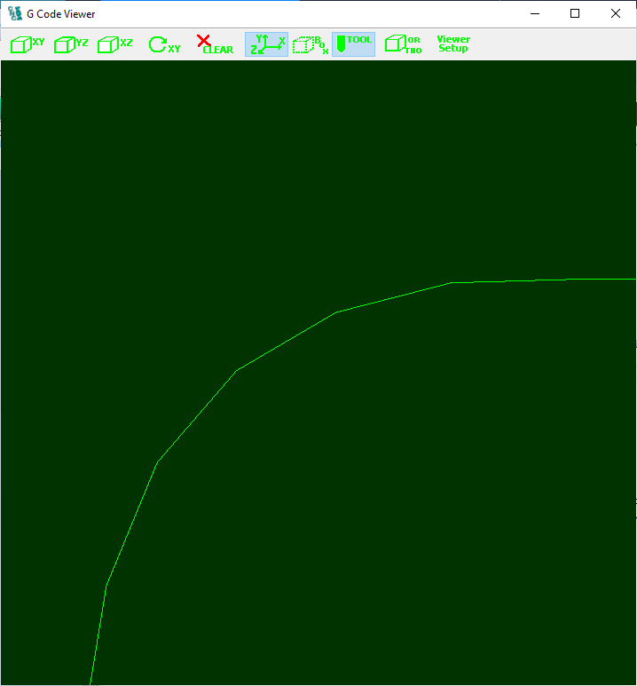

Another issue is the segmenting in the corners. Here is an example:
Normally Corner Rounding would smooth that out to avoid rough motion and some slow down. However there are significant AB angle changes (~5 degrees) for each segment. It is sort of complicated to explain but Kinematics is computed at segment endpoints and then the axes positions are linearly interpolated in between. Small segments along a curve will follow the curve with small errors and larger segments will have larger errors. For example imagine a point on your Table 10 inches away from the center of rotation. Then imagine the Table rotates 1 degree. The point will actually move through a arc. If instead we assume a straight line motion between the points there will be some error deviation. The amount of error depends on the angular change and the radius. The deviation is roughly proportional to the square of the angle and proportional to the radius. Here is a diagram showing moving from A to B through angle t:

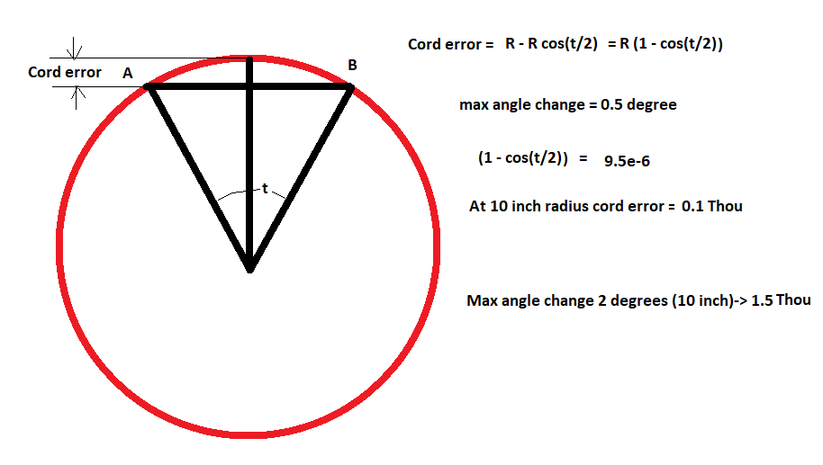

There is a parameter in the Kinematics to control the maximum angular change that is allowed without sub dividing the motion.
m_MotionParams.MaxAngularChange = 0.5; // limit the segment angle change for nonlinear systems
Your code set 0.5 degrees. This limits errors at 10 inch radius to 0.1 Thousands of an inch (4um). That seems excessive. I changed this to 2 degrees which limits errors to 1.5 Thou (60um). The resulting longer segments allow some corner rounding as shown below. Changing CAD setting to output shorter segments would also help.
Here is a patch for V4.35d. The changes are all within the GCodeInterpreter.dll. You should just be able to copy that to your Version 4.35d \KMotion\Release Folder. The binary and sources if you need them are located here.
Please let me know if this makes sense and what improvement or issues you encounter.

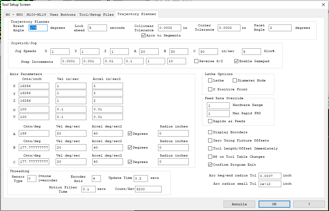

continuing testing the new SW trajectory planner, I have found the following issues, playing the attached 5 axis path:
- rapid moves (with all 5 axis involved) sometimes exceeds the maximum linear axis setup (both in init.c and kmotioncnc trajectory planner axis parameters): for example if you play with single step the gcode line N18 the maximum linear FR is ok, if you play with "gcod START" it doubles in my case.
I can solve the above issue limiting G0 lines with G1 FXXX but I would like to avoid that motors mill exceed their limits (avoiding lost steps), please indicate me how can I limit GO moves.

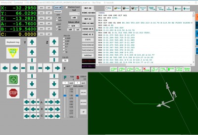

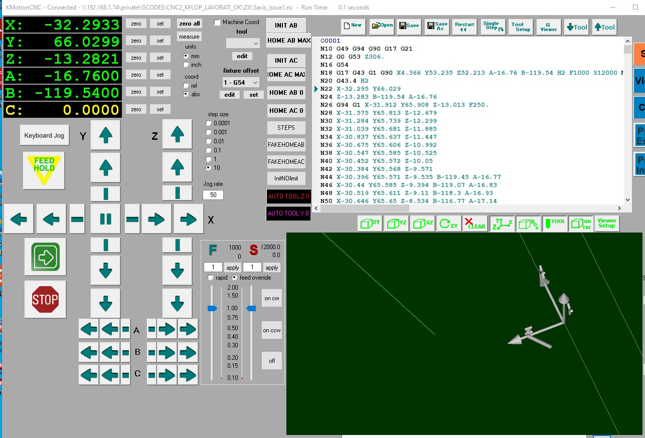

- the second and most important issue is in the gcode line N20 when calling the G43.4 command: once again if I run the line with "single step" everything is ok, but if I play during gcode (due to new mill point space position) the Kflop tries to command the mill stepper motors to make this "quantum leap" in a fraction of second and the steppers linear axis loose immediately steps/red driver alarm light switches on (I need to connect this alarm to the kflop in order to stop the gcode but this is another story...).
I underline the fact that if I run the lines till N24 with SINGLE STEP eveything plays OK: the mill does not move when calling the g43.4 command (only DROS change) and then in the lines N22 and N24 the mill reaches the above called "quantum leap". Please take a look to these pictures: just before G43.4
the "quantum leap" the mill reaches the new coordinates of G43.3 traslation with N22/24 lines
Starting playing the gcode in normal mode from N26 line the trajectory planner is perfect! Please give me a solution for the initial gcode part (G43.4 quantum leap issue) and the rapid moves in order not to loose steps/block the axis.

Regarding Rapids I believe turning on Rapids as Feeds option is required for nonlinear kinematics.
Regarding "quantum leap": That appears to be an issue with turning on and off TCP on the fly so that the GCode Coordinates become out of sync. Here is a patch for KMotion4.34d that should flush/sync whenever the TCP mode is changed. It also includes the previous patch for the Break Angle and your Kinematics changes. Copy this GCodeInterpreter.dll to your \KMotion\Release folder. If you need the changed sources they are here.
Please let us know if this resolves the issues.

so if I turn on "Rapids as Feeds", the G0 FR is determined by the axis parameters (vel/acc/jerk) inside the init.c file, correct?
