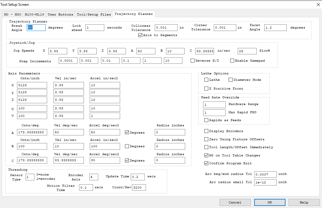

Hi tom,
here are the trajectory planner settings.
trajectory planner
Waiting for your kind reply.
Thank You
AMIT KUMAR
Posts: 2927
Re: Feed rate very slow in 5 axis simultaneous
Post by TomKerekes » Tue Sep 17, 2019 1:41 am
Hi Amit,
The issue is that the XYZ motion is very small (0.18mm) and the angular motions are quite large (C moves 9 degrees).
C axis Acceleration limit is set at 80 degrees/sec^2.
So the fastest possible motion is using maximum C Acceleration to move 4.5 degrees, and maximum C Deceleration to stop over 4.5 degrees.
The formula:
Distance = 1/2 Acceleration x Time^2
can be used to calculate the time required to accelerate (0.335 seconds) and decelerate (0.335 seconds) the C axis. Total Motion Time = 0.67 seconds.
Obviously moving XYZ 0.18mm over 0.67 seconds is not 2000mm/min. Rather it ramps to ~30mm/min then back to a stop to remain in sync with the angular axes.
Or looking at it another way: to move XYZ 0.18mm at 2000mm/min would only take:
Time = Distance/Velocity = 0.18mm / 2000mm/min x 60sec/min = 5 milliseconds.
Imagine your C Table attempting to rotating 9 degrees in only 5 milliseconds!
KMotion's Trajectory Planner goes through great effort to move in the optimal manner, while honoring all the constraints of your machine.

Posts: 2927
Post by TomKerekes » Tue Sep 17, 2019 5:22 pm
Hi Amit,
You must obey the laws of physics. If the GCode commands the C Axis to move 9 degrees, then the GCode must take the time it takes your C Axis to move 9 degrees.
The only options are:
#1 change the GCode to move the Trunnion Tables less
#2 change the machine to be able to move the Trunnion Tables faster
You can change the Trajectory Planner Accelerations and Velocities to huge values but if your machine is not capable of this then there will be huge errors and motor stalls.

Posts: 2927
Post by TomKerekes » Wed Sep 18, 2019 3:48 pm
Hi Amit,
I don't think setting a radius would be appropriate for you. That method is for systems that operate on a cylinder of relatively constant radius such as this:
With Radius = 0 only XYZ are used to determine the desired Feedrate (if the Feedrate is achievable)
With Radius > 0 the radius is used to transform angular motion to linear motion (angle in radians x Radius) and assumed to be orthogonal to any XYZ motion. This can be useful so a simply specified Feedrate can achieve an approximate cutting rate even when angular axes are used or combined with linear motions.
In your case it wouldn't be appropriate or help as the motion is limited by what your C axis can do. Whenever the desired Feedrate is higher than what some axis can do that axis will limit the rate.

Posts: 2927
Post by TomKerekes » Thu Sep 19, 2019 3:14 pm
Hi Amit,
You don't respond to my previous posts so it is hard to tell what you understand.
Please help on how to implement G93 feedrate for this controller.
and how it should work
it works an most others. Here is a reference. What don't you understand?
Again if you use G94 or G93 to make a motion in 5 milliseconds that your machine can only move in 1 second, then the motion will still take 1 second regardless.
Should i do motor tuning again for this feed rate issues ?
Are your Velocities and Accelerations for your axes set properly? For your C Axis you have a maximum velocity of 83.33333 deg/sec and an acceleration of 80 deg/sec2. This means the axis takes over 1 second to accelerate to full speed. That seems a little slow. Have you tested higher acceleration? Does it work with small following errors? You might read this.
And in Step response screen, how should i do motor tuning for Rotary axis with counts/deg in trajectory planner.
To convert counts to degrees divide by the counts/degree for the axis in exactly the same way as with a linear axis where you convert from counts to mm by dividing by the counts/mm for the axis.
I started doing same as step response for linear axis but, rotary axis is going extremely fast.
Then move slower.
How step response works in case of Rotational axis in Trajectory planner.
Exactly the same as with a linear axis.
