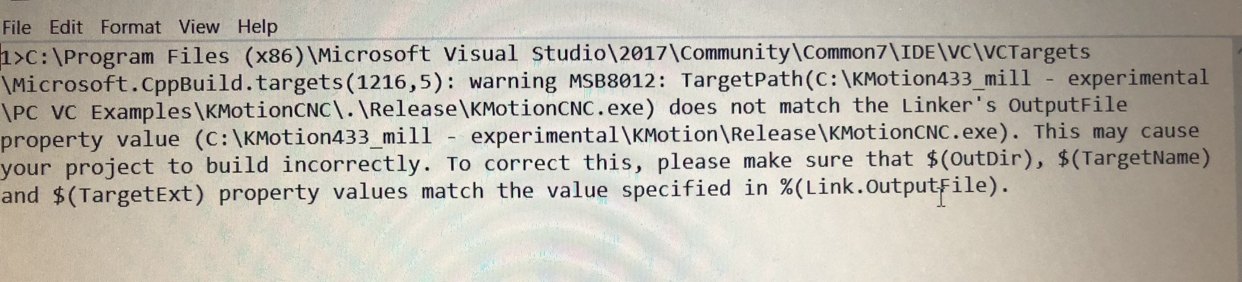

Re: Customizing gamepad interface
What is the ideal Visual studio to install ?
I had 2017. It did an import and had me add mfc 8.1
(probably) and rebuilt. There were some warnings but
no errors. It couldn’t find the exe to run and gave me
a long message about linker. I tried it with vs2015 but it also required an import of the project and it gave hundreds of errors.

- Posts: 2928
Hi BillK,
The projects are compatible with VS2015 without any upgrading. See here.
Make sure you are using our latest Release Version 4.34
VS2017 should also work but when Microsoft upgrades the project the Target Directory is not maintained correctly. So you will need to correct this.
