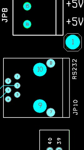

Can you confirm what side should be pin 1? The diagram I found put it on the left side facing the connector with the KFlop/Kanalog upright, which would seem to tie in with 5v on pin 2 from the click.

Hi Moray, It does look like our numbering is backwards. Pin 1 is on the side near JP8. See attached. Regards TK

Tom, that would explain why I was seeing activity on what should be the Click Tx line with no lights flashing on the Click. I'll make up a crossover cable in the morning and retry. The Click is grounded on pins 1 and 6, so the ground should be fine. I've uploaded the port 2 diagram to the files section for reference. The only physical difference from Port 1, is Port 1 doesn't have an RTS connection. Thanks Moray ---In DynoMotion@yahoogroups.com, <tk@...> wrote:

Hi Tom, I made up a crossover cable this morning (just X'ed the centre two wires), plugged it in, launched the sample thread, and everything burst into life how it should. Ticking the virtual bits in KMotion activates the PLC outputs, and activating the PLC inputs activates the virtual bits. Now I just need to figure out how to read/write the required locations in the PLC... Thanks Moray ---In DynoMotion@yahoogroups.com, <moray.cuthill@...> wrote:

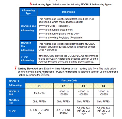

Hi Moray, The ModBus example is table driven so just by adding the Registers to the tables should cause the Registers to be Sent or Received to the MBregister Memory. But then you need to add more code to move the data to/from wherever you wish - in your case probably a persist.UserData Variable so the PC can read it. HTH Regards TK

Tom, I've managed to decipher the example so I know what I need to change, however I'm having a problem reading the correct register. I'm trying to read the contents of the holding register DS1, which according to the manual, shares the same modbus hex address as the first inputs (X001) with the only difference being the preceding function code. So using that info, I copied the sample read line- {"\x01\x04\xE0\x00\x00\x01", 6, 0}, // Read inputs to MBRegisters[0] and came up with {"\x01\x03\xE0\x00\x00\x01", 6, 2}, However, this is still reading the input registers. Having read the manual a bit more, a 04 code should also read the holding registers, but it somehow manages to read the input register??? Can anybody explain how to adress the holding registers? Thanks Moray ---In dynomotion@yahoogroups.com, <tk@...> wrote:

Here's the relevant extract from the Click help file.
Moray

Hi Moray,
I think there is a utility program called "Address Picker" that comes with the Click to help figure things out. First see if you can get it to generate the sequence in the example that works. Then see if you can get it to generate a sequence for something else you wish to read.
Regards TK
| Group: DynoMotion |
Message: 8647 |
From: Moray Cuthill |
Date: 11/15/2013 |
| Subject: Re: Modbus example not working |
Hi Tom, I finally figured it out. What was throwing me were the E000 and E200 addresses used in the example, when the input (X) and output (Y) addresses are listed as 0000 and 2000 respectively. Also adding to the confusion were the use of function codes not valid for those registers.
After sitting going through the address picker (this is what you're referring to) last night, I realised that the example reads and writes the XD and YD registers which use addresses starting with E, and contain the X & Y values but accessed via hex values in blocks.
The _D registers are something that for somebody new to PLCs like me, you probably won't know they existed, let alone of used them. So I've altered the sample to use Function code 03 with address 0000, and it's now reading and printing the DS1 register to the console. I've also added a couple lines to write a new value to DS2 aswell, using function code 16 (hex 10) address 0001, and that's working aswell.
Now onto making the code do what I need it to! Thanks Moray | | | | | | | | | | | |
