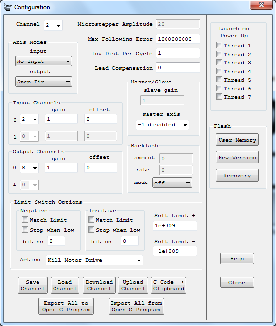

Hi Steve,
Yes the screen shot looks correct. But "OutputChan2=8" is incorrect and invalid. In some Output Modes a KFLOP Axis Channel can require 2 output devices. They are called OutputChan0 and OutputChan1. Step/Dir Mode only use one Step/Dir Generator device so only OutputChan0 is used to specify
which Step/Dir Generator to use. So in verbose English to :set KFLOP Axis Channel #2's First Output Device Channel0 to use Step/Dir Generator 8 the C code is:
ch2->OutputChan0=8;
Yes add the FPGA setting to your Initialization C Program at the beginning of the main function.
Yes you can add encoder feedback. It really doesn't work well to correct for stepper stalls and missteps. But it does allow you to detect them and stop rather than going on blindly forever possibly causing more and more damage. It also allows recovery from a fault or amplifier disable without loss of position which would
normally require re-homing. In some cases the feedback can be used to observe, plot, and potentially dampen oscillations. If Linear Encoder Scales are used instead of rotary encoders then accuracy may be improved by reducing errors such as leadscrew and backlash errors.
HTH Regards TK

Hi Steve,
ch2->OutputChan0=8;
HTH Regards TK

Tom, thank you for the clarification, Yes my encoders are linear "glass" scales
