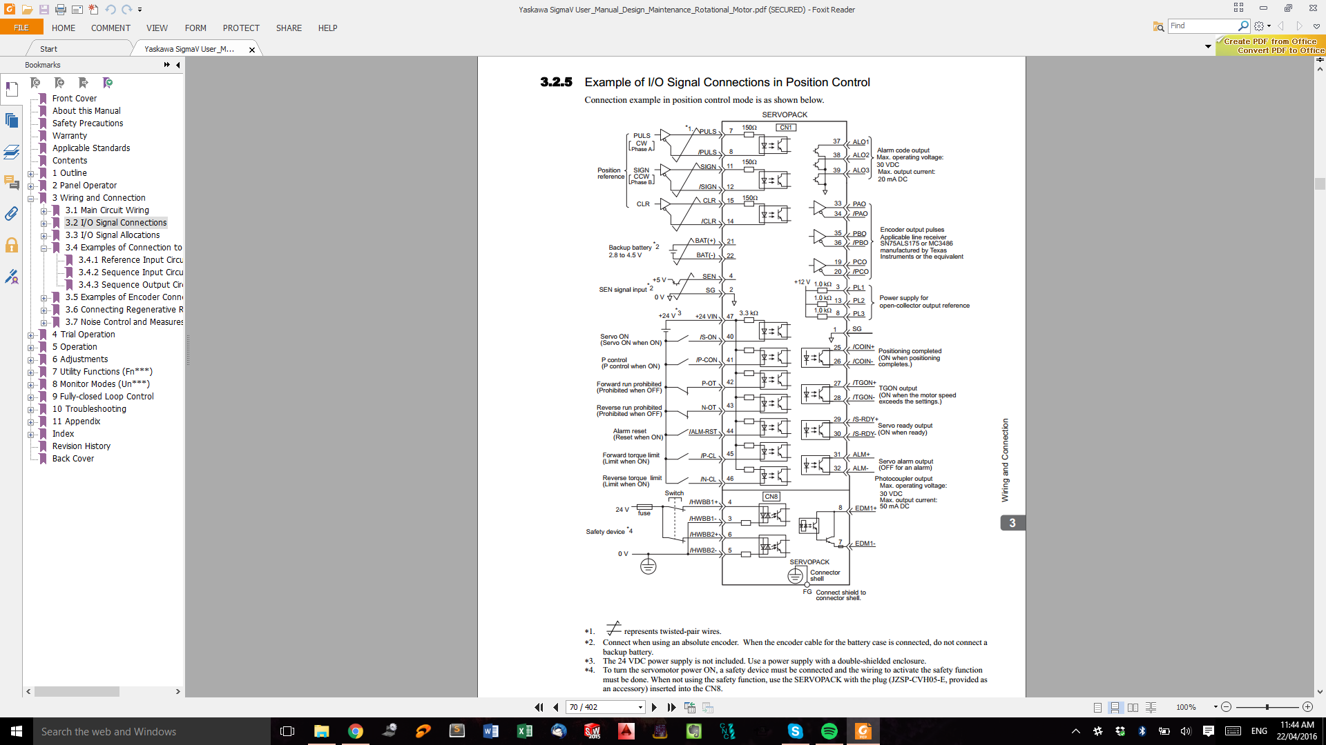

I'd like to use the Yaskawa's Z phase outputs to perform index homing, but to my knowledge the only output on the Z phase is quadrature, and with the spindle's A+B+Z phase occupying JP1 channel 0 and 1, I do not have enough channels left on JP1 to put all 3 axis drive Z phase outputs there.
So far my thought has been to use an MC3486 differential line receiver to convert the quadrature outputs into single ended for the KFlop to handle on some input (not sure about this - I'm not an expert with electronics).
Does this sound reasonable?
Is it impossible to have two Z phase outputs in one Kanalog encoder channel?
Perhaps someone has experience with these drives and can tell me whether they support an open-collector output for the Z phase (many drives do).
Finally, I've attached a screenshot of the manual describing the outputs, if it's of any use.

Hi Lindsay,
You should be able to make use of the 8 differential inputs circuits on Kanalog JP2 for Z index pulses by wiring the signals coming out of Kanalog JP9 back into the GPIO inputs on Kanalog JP12.  Don't worry about connecting the 5V TTL outputs to the 3.3V inputs as those outputs do not drive high enough or with enough current to be a problem.
You only need 4 so wire:
JP9 Pin1 to JP12 Pin1
JP9 Pin2 to JP12 Pin2
JP9 Pin3 to JP12 Pin3
JP9 Pin4 to JP12 Pin4
The Z Index inputs should then show up as I/O 128, 129, 130, 131.
