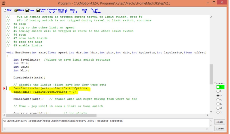

Hope you don't mind the direct email.  If so, let me know and I'll post in the group/forums.  I'm trying to compile the HomeMach3Kstep.c file that is provided with the KMotion software.  I'm getting a compile error at the point in the program where you save your current limit switch settings and/or re-establish your old limit switch settings.  The compiler is giving me a "pointer expected" error anywhere the "->" operator is used.  Please see the attached screenshot.  Any help would be much appreciated.  BTW, I'm running Windows 8.1 64 bit if that makes any difference.

"chan[axis]" is an axis channel structure.  To get an element of the structure in C use the "." operator.
SaveLimits = chan[axis].LimitSwitchOptions;
This is different from when you have pointer to a structure.  In that case you would use the "->" operator.
