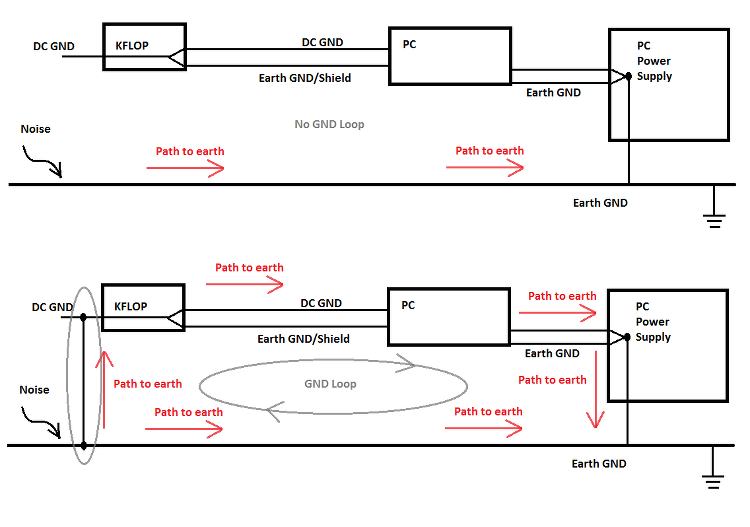

Hi easydigisoft,
You should not connect KFLOP DC GND to earth ground.
Do you have a Kanalog? Make sure you have reverse diodes connected across any relay
coils. A separate power supply may help but should not be absolutely necessary.
Regards TK

Thing is that if the KFlop is connected to a PC with USB cable, the ground on the USB will be PC ground, which is also tied to earth ground thru the PC power supply. Michael Rosenfield

Hi Michael,
That is true (assuming no USB isolator). But making another connection from KFLOP to earth ground creates a Ground loop which forms a path where earth ground currents can now flow through KFLOP and the USB cable to get to earth ground.
It isn't always this simple but see the attached diagram for the basic idea.
Regards TK

There are USB isolators out there; they will keep the KFlop ground separate from the PC ground. They optically isolate all the signals, as well as power and ground. I bought one for about $30; I am not actually using it because I'm not having noise issues. My machine is in a light-industrial area, so the biggest machines are a bunch of 5 HP air compressors. Michael
