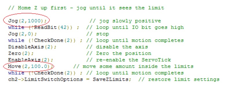

Greetings,
I am having trouble getting one of my axis to home. When it is jogging in the positive direction it seems to work just fine. The problem starts when I try to reverse the homing direction (make the 1000 negative. I am also not able to change the direction that the axis moves after homing. It will only move in a positive direction - if I make the 100.0 value negative it wont work.
When I attempt to do this and download/compile the program the feed hold triangle starts flashing. The strange thing is on my other two axis I am able to change both of these directions simply by making them negative. Anyone know what I am doing wrong?
// Home Z up first - jog until it sees the limit
Jog(2,1000); // jog slowly positive
while (!ReadBit(42)) ; // loop until IO bit goes high
Jog(2,0); // stop
while (!CheckDone(2)) ; // loop until motion completes
DisableAxis(2); // disable the axis
Zero(2); // Zero the position
EnableAxis(2); // re-enable the ServoTick
Move(2,100.0); // move some amount inside the limits
ch2->LimitSwitchOptions = SaveZLimits; // restore limit settings
