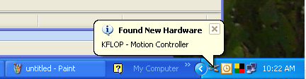

The first time the KFLOP board is connected to a computer's USB port this message should be displayed near the Windows™ Task Bar.

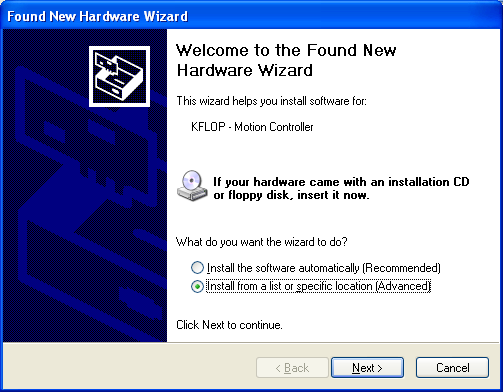

Shortly thereafter, the New Hardware Wizard Should appear.
Select "Install from a specific location (Advanced)" and select Next.

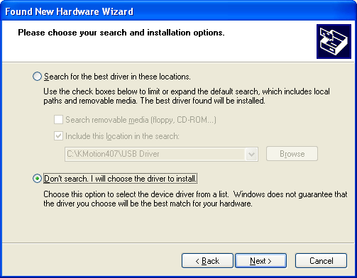

Select: "Don't search.  I will choose the driver to install" and click Next

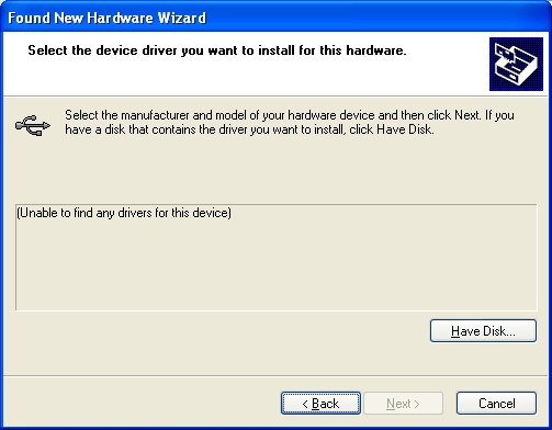

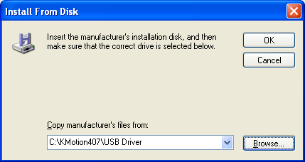

Select: "Have Disk..."
Browse to within the subdirectory where you selected the KFLOP Software to be installed to the "USB DRIVER" subdirectory.
(If the software was installed into the default subdirectory, the location would be: C:\KFLOP4xx\USB DRIVER)
Click OK

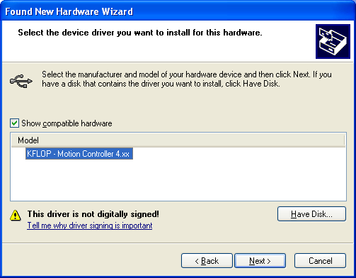

Select "KFLOP - Motion Controller 4.xx" and slelect Next

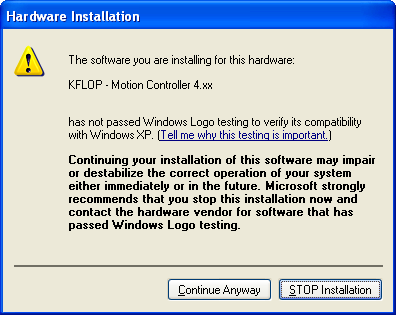

If this screen appears select Continue Anyway.

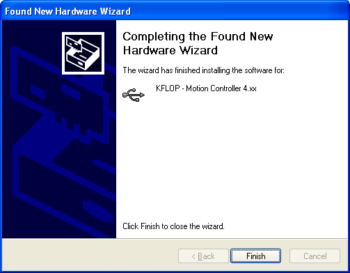

If successful, the above screen should appear. Click Finish.

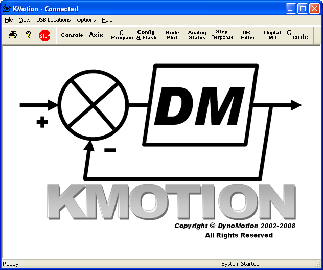

The KFLOP Board is now ready for use.  To verify proper USB connection to the KFLOP Board, use the Windows™ Start Button to launch the KMotion Application.

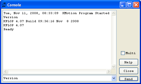

At the main tool bar select the "Console" button to Display the Console Screen.
Enter the “Version” command and press the "Send" button to send the ‘Version” command to the KFLOP Board.  The following should be displayed indicating successful communication between the PC and KFLOP Board.
KFLOP 4.07 Build 09:36:16 Nov 8 2008
KFLOP 4.07
Ready
